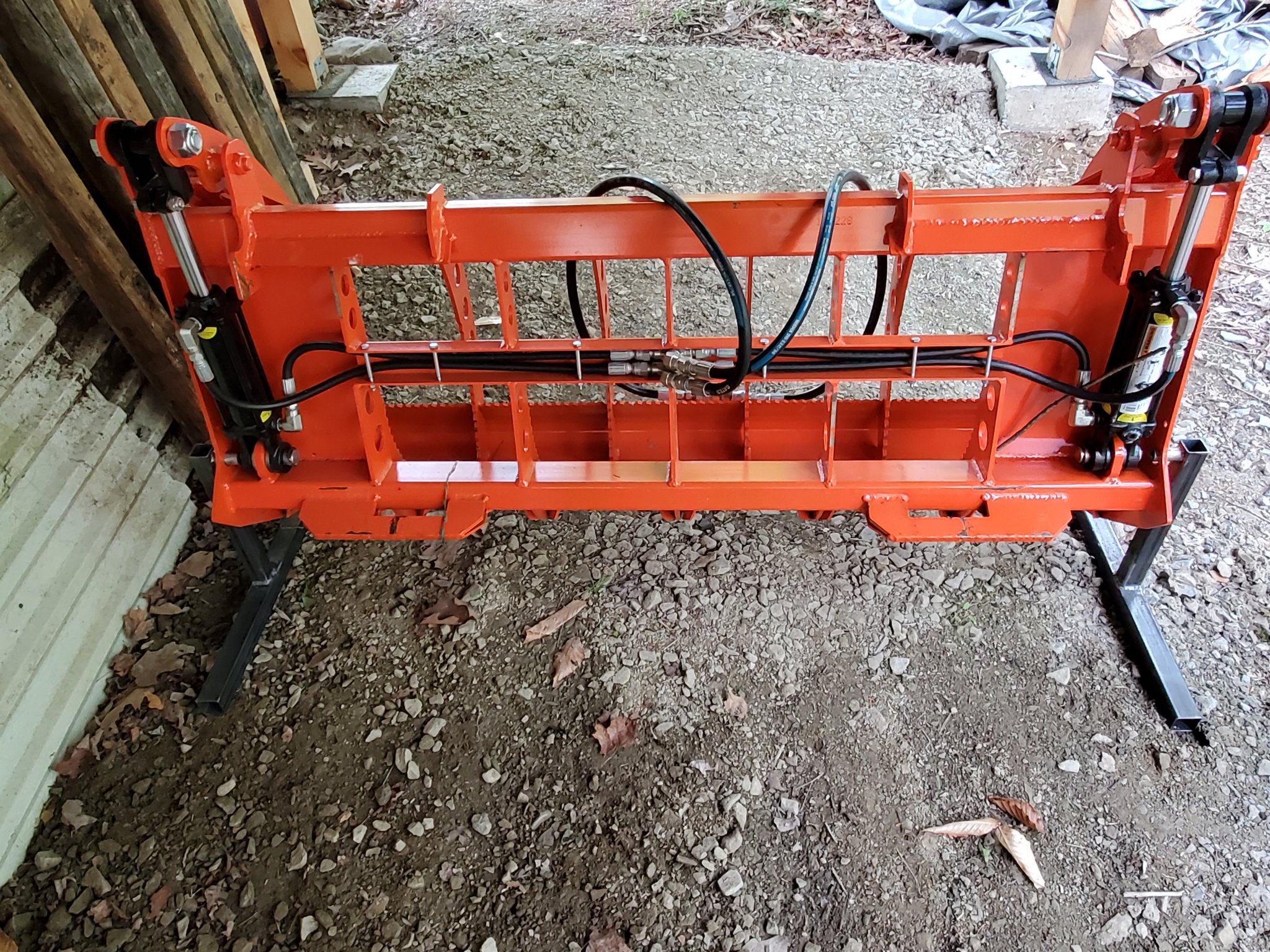

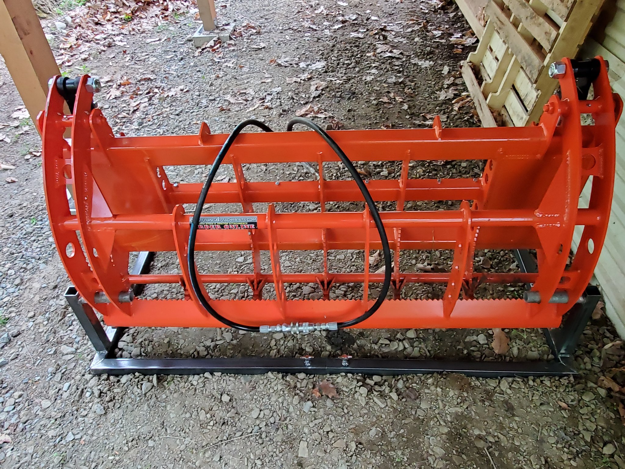

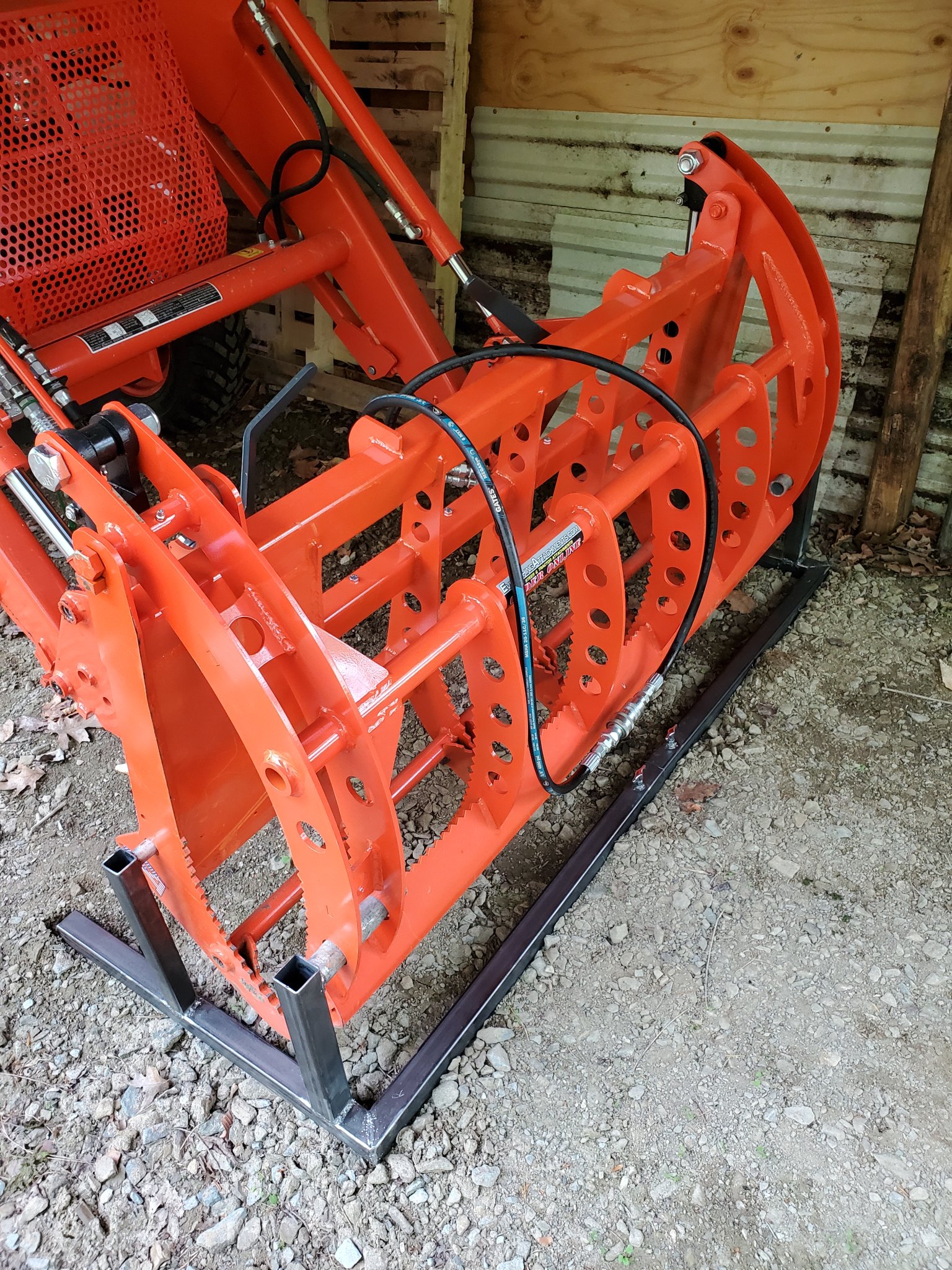

After storing my wicked 55 on the original shipping pallet I thought there must be a better way to store it when not in use. The wheels started to turn and I came up with a simple idea for a stand. Now all I needed was a little spare time to get started. Necessity is the mother of invention. I needed to take the grapple off the tractor to use the forks and I was reluctant to drop it back on the pallet. Today was the day. I got to work and as usual I had more time in this project then I anticipated. It's not totally finished at this point but it is totally functional.

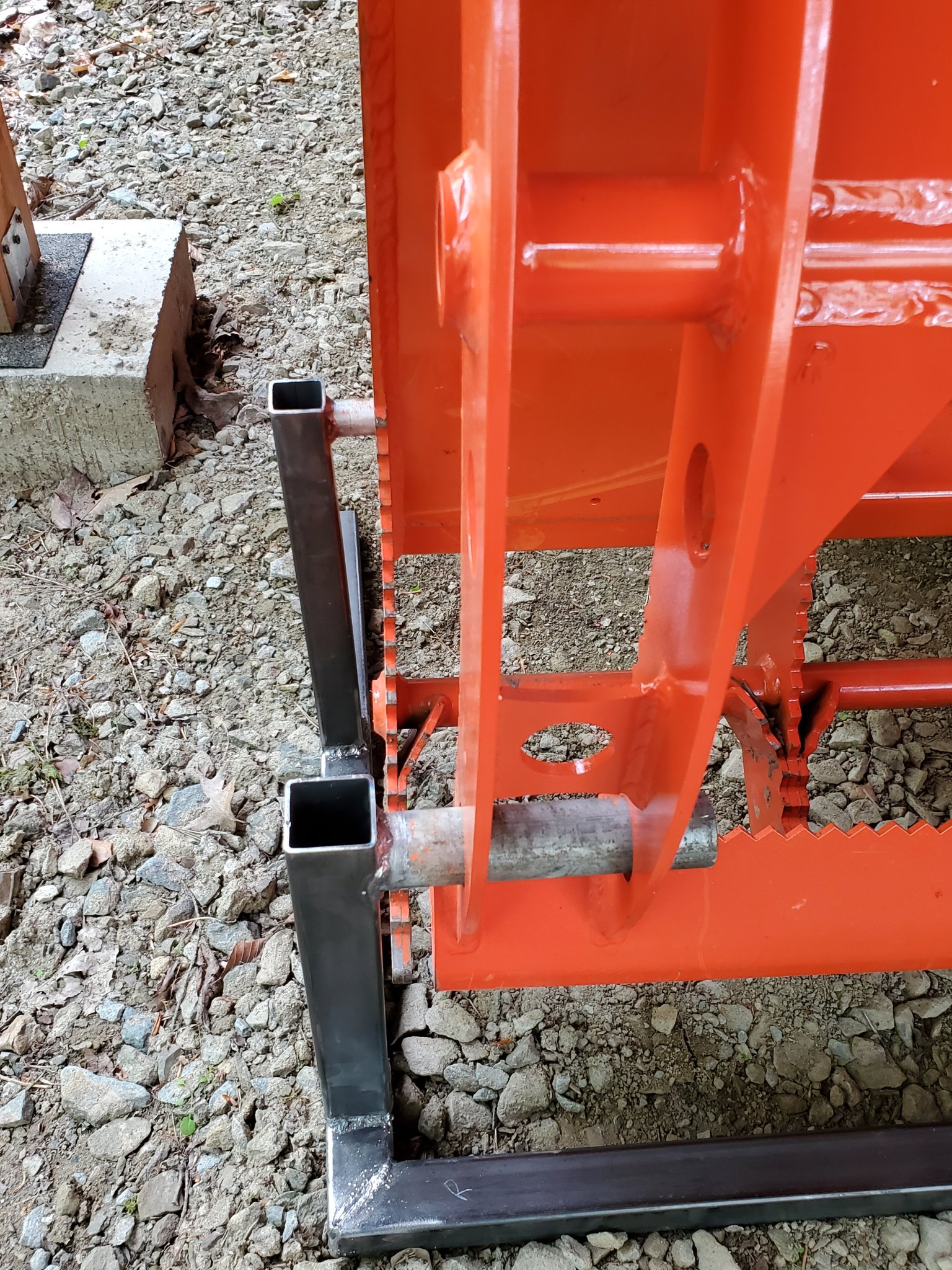

I rounded up some scrap square tubing around the shop and got to work. First I took measurements and made all the cuts. I followed that up with welding everything together. I still need to fabricate some end caps and possibly some more reinforcement tubing then finish with a nice coat of paint but that's for another day.
It's basically a two piece stand. It separates in the middle so you can spread it for installation. Once in place you tighten the "T" handles to lock it all together. Then lower the grapple to the ground, release the SSQA, and back away.

That's a really good solution. Well done! (y) I just sit a block of wood in the center under the cross member but your solution is much nicer and definitely more stable when hooking back up to the grapple.
Thanks! Your method works, as did mine, but I needed something more user friendly.
I had two issues: first, I had to wrestle with the grapple on the pallet to install it this spring because it wasn't situated correctly. I'm getting to old for wrestling matches.
Second, I needed a stand so I can store it in the shop at some point and this allows me to slip the my pallet forks underneath to combine the storage space.

How difficult is it to get the grapple adjusted to allow the pins on the side to slide in? Nice set up, but the alignment seems like it would be a challenge.
I have a different style of grapple and simply set it on an old 10 ply tire. Never had any trouble connecting in 4 years.
I set it up so that all the pins line up with the grapple fully closed so there would be no issue lining them up.

@MountainMeadows Great idea!
I'm going to use this same concept (pins from the outside) to build a two-piece stand. One stand for each side. The grapple is definitely an awkward piece to mount/dismount and not easy to move around the shop unless it's on wheels.

Nice job!
Are you going to weld a mounting plate to bolt the casters to?
Thanks!
I'm either going to weld on a mounting plate to bolt the casters to or weld the casters directly to the square tubing.
I'm debating on whether to use 3" or 4" casters. It seems 4" might roll better on uneven surfaces.

My advice is to go as big as you can in diameter. After having used those 6" HF casters, I'm sold. Crazy easy to roll around the shop.
By using a mounting plate, you avoid having to possibly cut off a failed caster.
Although it could be argued that having to drill 16 mounting holes takes more time than cutting off a few small welds.
6 of one, half dozen of the other argument I suppose.
