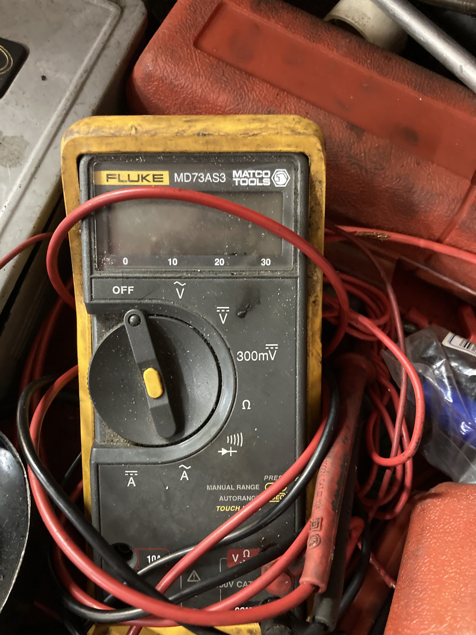

Here is arguably one of the most useful tools I have.
I can't believe I paid something stupid......(like $500 bucks for that thing)....many, many, many moons ago.....Now they are like $16.99 or something like that. :unsure:
But I also can't believe there are people out there that don't have one......
I guess I will chalk that up to my amazement that there are people out there without compressors too (or air tools......or welders.....or lathes....or CNC plasma cutters........etc....etc....)
I'm just "easily amazed" I guess.:D:D:D
Not only do most people not own a VOM, but they wouldn't know how to use it if they did.
Own one? Just did a quick count and I have 8 including an old Simpson analog meter. They all get used a lot. Throw in a dual channel Oscilloscope and a variable DC power station to round it out for V/IR. I have a kit from my first job they were gonna trash that can terminate anything from coax to fiber and test it too. Don’t get me started on the spools of cable and assorted connectors to make my own. My favorite least used tool is the powered wire wrap gun for replacing broken wires on the back of old school circuit boards. Ahh memories. No fun tools like plasma cutters, lathes, end mills……

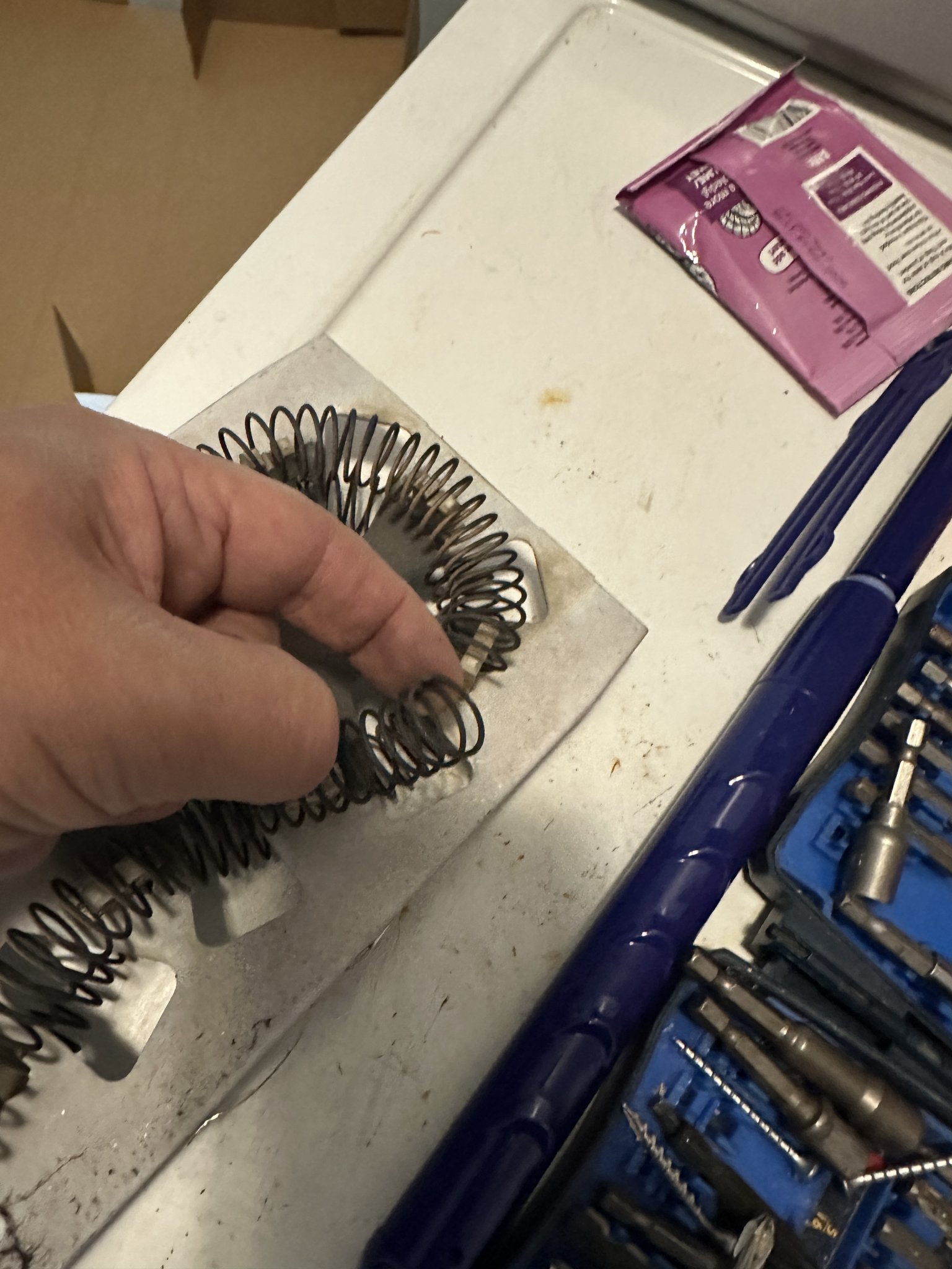

Here is a pro tip for fixing an inoperative electric clothes dryer heating element.
They always fail on a weekend when you can't buy replacement appliance parts.
Take the nichrome heating element wire coil where it burned through, and using needle nose pliers,
straighten each end until you have a 1/4" to 3/8" straight section of wire.
Using stainless steel hardware, which is available at Lowe's & Home Depot on the weekend, take a 8-32 stainless steel screw, a nut, lock washer, and two flat washers, and clamp the two ends of the straightened nichrome wire between the two flat washers. This will get you operational again while you order replacement parts.
Obviously, this is a short term repair, I've done it personally and it will get you up and running for several weeks while the new heating element is being sourced.
Dad showed me that trick a long time ago, it's worked for me twice.
