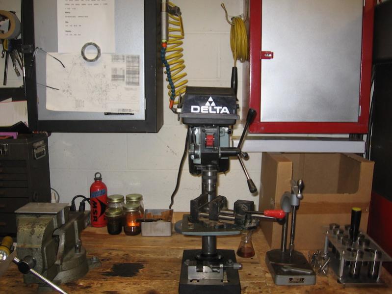

I have two.
One is small Delta benchtop that I bought at a moving sale, still in the box. The guy wanted $125 for it in the morning, but I got it for $35 at the end of the day. (he didn't want to take it on his move) It's fine for small stuff, but the RPM range is too high for the big stuff. For that I use the vertical mill.
