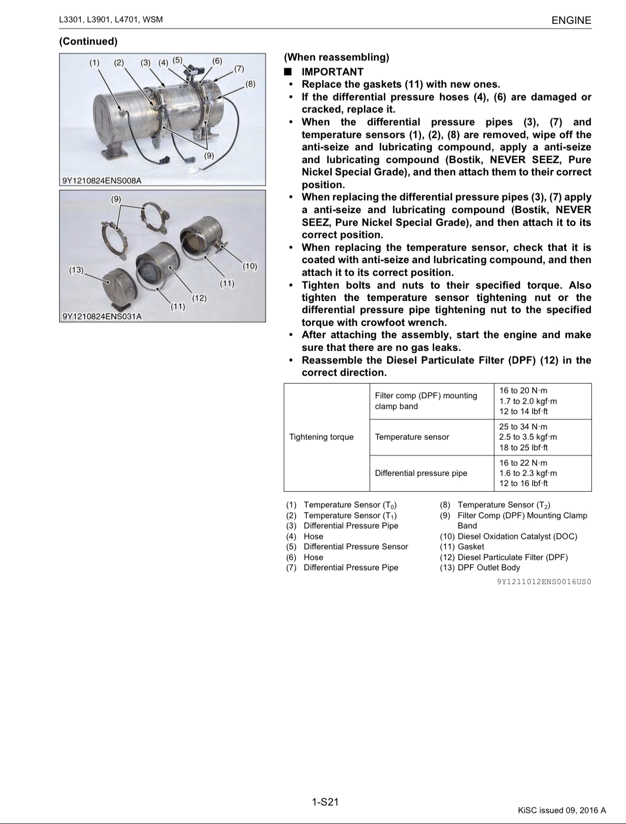

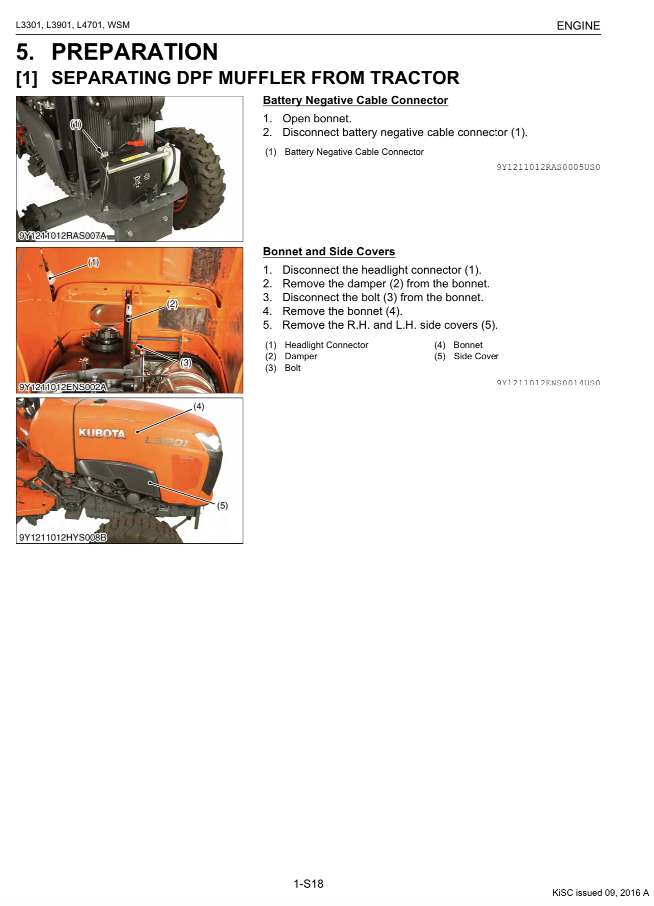

C Cathouse New member Equipment L3301 Aug 19, 2023 24 2 3 Rawlins, WY Jan 4, 2024 #1 Anyone have any info on removing the DPF Canister on a Kubota L3301. A video wood be great!!
Fordtech86 Well-known member Lifetime Member Equipment L3200 Aug 7, 2018 4,966 5,916 113 Pineville,LA Jan 4, 2024 #2 Sorry no video… https://www.kubotabooks.com/AutoIndex/index.php?dir=Tractor%20Owners%20Manuals/&file=L3301%2C%20L3901%2C%20L4701%20Workshop%20manual..pdf Maybe that helps?
C Cathouse New member Equipment L3301 Aug 19, 2023 24 2 3 Rawlins, WY Jan 4, 2024 #3 Thanks alot, way better than what I had!! Reactions: 1 user
