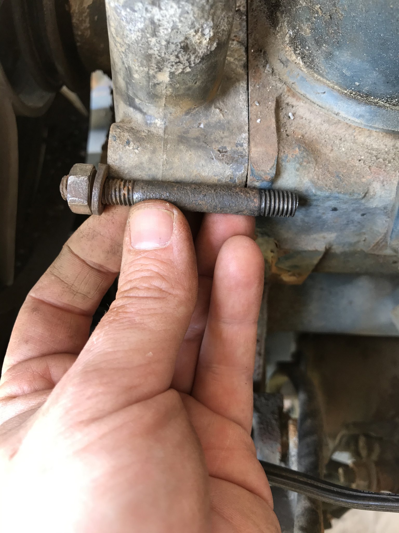

Replacing the coolant housing on l1500. Besides the fact that one bolt hits the fan assembly the other issue is this post and nut setup. How are you supposed to turn a rusty post when the nut comes off. There are two like this out of six. I got the one in the picture out because the nut was rusted on.

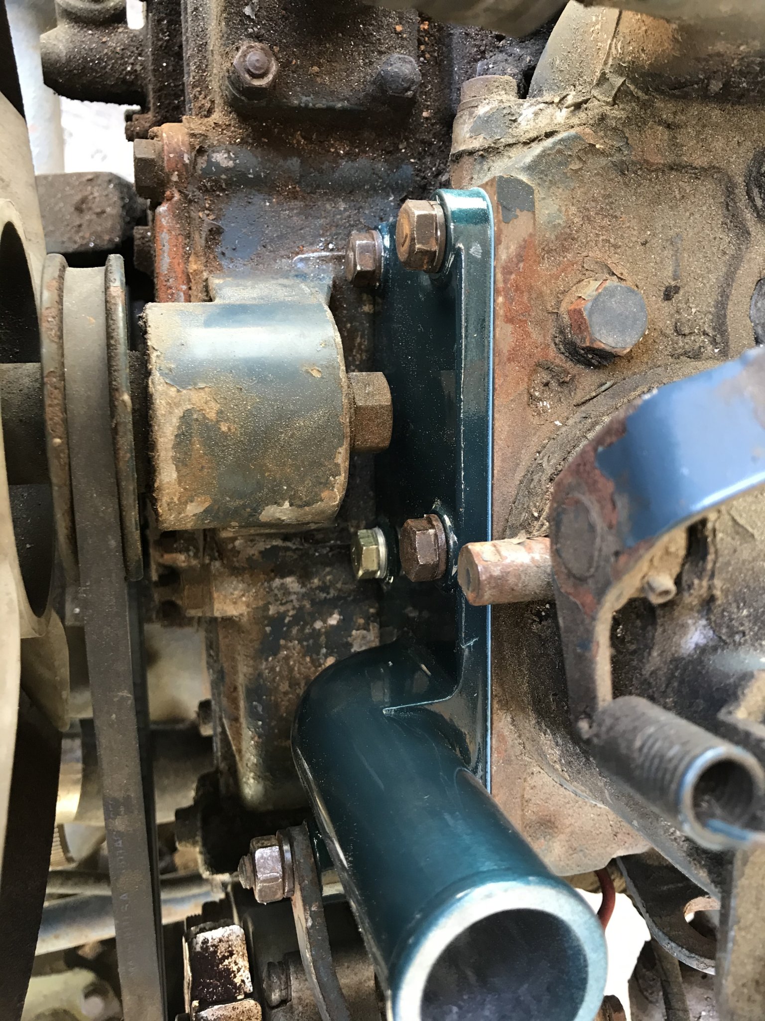

I can’t take off the housing without taking the post out or removing the fan mount which appears not removable. Cast onto the engine?
thanks much!
- Mike

Isn’t really the issue but the mount. Neighbor is coming by to weld a nut on one of the bolts that I sheared the head off on. I’ll see if he can weld a nut on the post so i can get it out. That was my original plan but still not sure why 4 of these are bolts and 2 are post and nut. Maybe they expect you to some how remove the fan assembly mount and just leave the posts in but I don’t see how. Sure I could remove the fan but doesn’t help me.

taking off the fan doesn’t get me any room. It’s the mount the fan goes into. That mount is part of the gear case. I.e. have to remove the fan and the gear case.

In your first picture by your index finger is that a crack in the cover, if so will you repair the crack or replace it? If other methods to remove the remaining stud doesn't work, could you cut the cover to release the stud then remove it. If this cover is part of the head assembly then would it be quicker to remove the head? If you're successful on removing the cover perhaps bolts in lieu of studs may be a better application. The anti-seize isn't a sealant but helps retard electrolysis and aids in removal at a latter point. Not to expand upon your project but what condition are your fan bearings? Are they greaseable, sealed, shielded? If they has excessive play, it may be a good time to address them while you have an extra inch or so. Good luck

Yes a crack. I did not notice until I was removing it so not sure if it happened in removal or if that was my leak. I have a leak somewhere on the flange or maybe where the inlet hose attaches. It’s hard to find with the fan whipping the coolant everywhere. The inlet was pretty corroded so replacing. Easy job. Only nothing is easy on a tractor pushing 50.

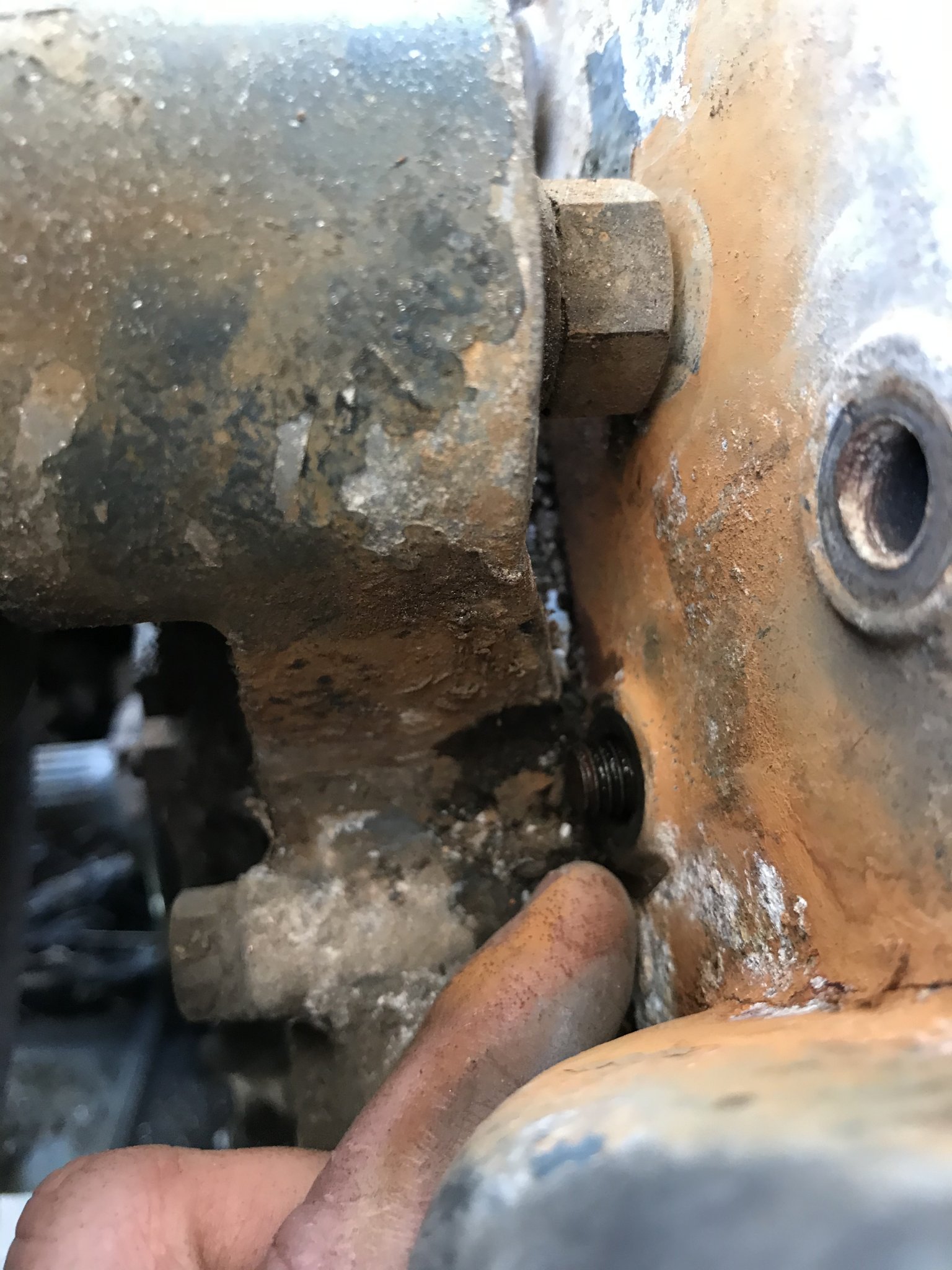

Phaw! Hahahahah. So the bolt on the fan definitely interfering with the angle to get out the flange. I guess I have to remove the radiator to get something on the front of the fan to keep it from spinning to remove the back nut? I don’t feel anything though. Sometimes a man has to find out for himself. It’s getting comical.

my new plan. The nut wasn’t rusted so bad on the post. Jb welded the post. Will try to get it out tomorrow once it sets.

Jb weld no go. It didn’t get in threads was too thick just got pressed out. I turned my attention to the broken bolt which was essentially the same problem now. I had been spraying it with penetrating oil each time I walked by. Ground two flats side on the stud. Put a pair of vice scripts on it and came right off.
what the hell. Let me just try to really clamp down on the center stud with the vice scripts and see what happens. Turned right out.
Only problem maybe is some oil came out of the center stud. I thought it was penetrating oil but definitely diesel oil.
problem? Or my design. How do I tell if the bolts are blind or not. The center stud definitely appears to end on the casting but maybe it turns down? How else would oil get in there.
