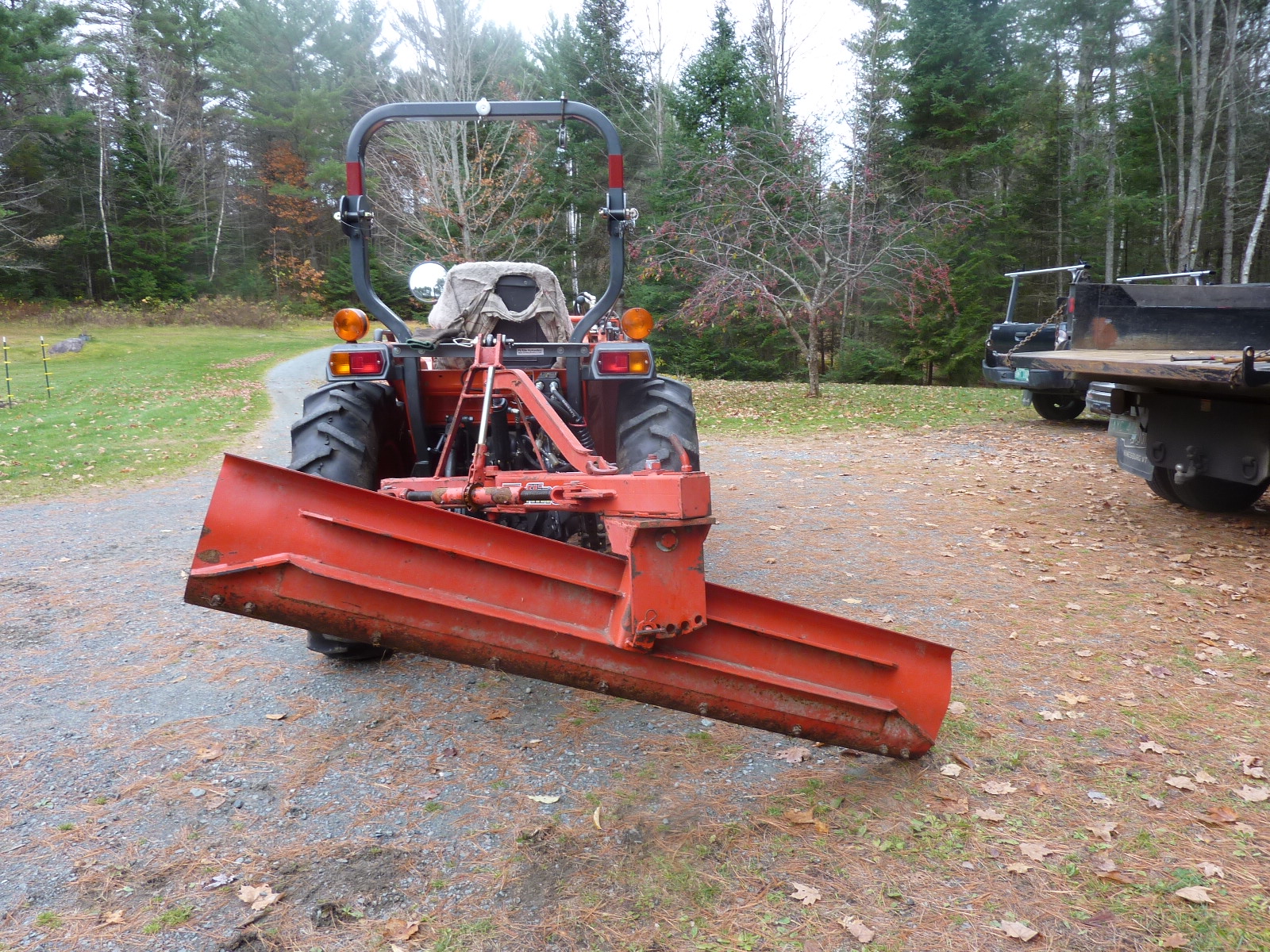

Tilt allows you to quickly and easily make 'swayles' and berms, aids in cleaning out ditches. My 70 year 'young like me' Oxnard is GREAT at that ! At 6' covers the tracks,spins 360, tilts and can adjust 'pitch' or 'cutting angle' of the blade.
While 'offset' ( left or right, might be nice, I'd just plan ahead the job to figure out how to do it. Yes, I'd take a few more passes but job got done.

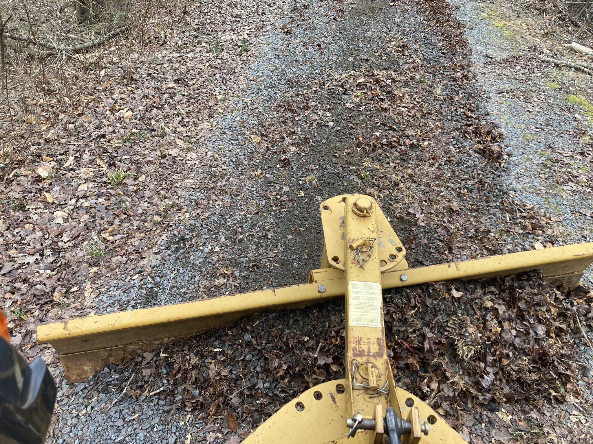

This is a Leinbach I recently borrowed from a friend to smooth out a washed out gravel drive. It had all the adjustments and I want one. I googled Leinbach and EA comes up (n)
8,001
5,188
Leinbach went out of business!
EA called that their,...... "6 Way Deluxe Scrape Blade"
