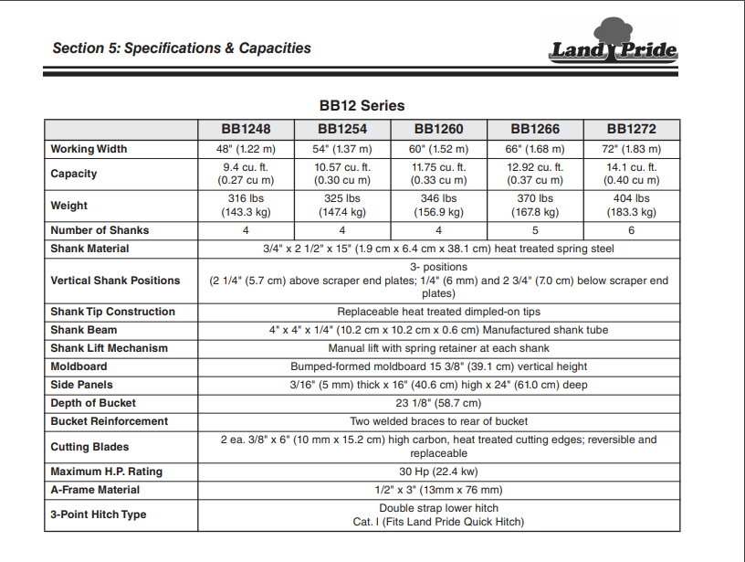

So here was the icing on the cake, so to speak.... ;)
The Land Pride BB1248 is 41lbs heavier than the EA LS48. I posted both products so you can see the differences. (this is not shipping weight either) Weight is pretty important in my opinion. The heavier it is, the better it can dig down.
As for price, EA wanted an extra upcharge to deliver it to my house. Dont quote me, but i think is was an additional $140 on top of the already $640 price of the box blade when i called them last month. Their FREE SHIPPING can be a little deceiving too. (free shipping within 1,000 miles!) I qualified for the free shipping if i wanted to drive 100 miles just to go pick the box up at the freight company where they would drop it off at, then 100 miles back home. This was not a economical choice in my opinion. By the time all said and done, i would have had to spend money on top of additional fuel used on the trip there and back. The Land Pride BB1248 made far more sense, economically, for me. They are BOTH great box blade`s, and BOTH will work great. Dollar wise, the LP was the final choice, for me. When you`re disabled, money becomes a deciding factor when you live on a very limited income.

Land Pride Spec Sheet:

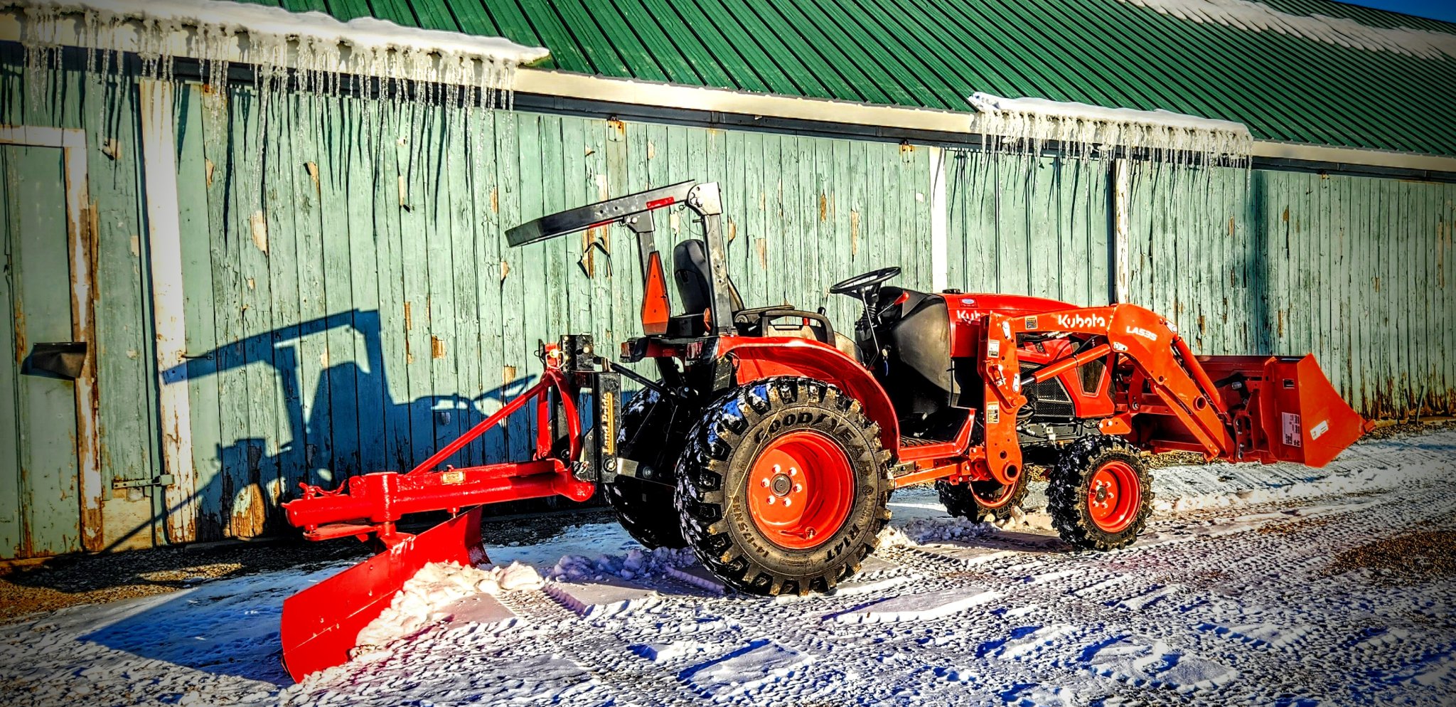

At first the clips were a pain but I always carry a pliers on the tractor now as they are very hard to get out without the pliers.
My wife was complaining about the slippery wet hard pack snow/ice that was in front of our north facing 40x60 machine shed that we park cars in. Today we had temps in the mid 40's and took the box blade out and cut grooves in the ice along with bringing some gravel up to give some added traction. I didn't take a before pic but you can guess as to how slipper it was before I worked it up.

That`s a great idea breaking up the ice with the box blade, i hadn`t even thought of that till you mentioned it. I think the shanks would do the trick for our driveway because it gets so much ice built up thru the wintertime. Its hard on buckets and blades trying break up the ice for us where we live. Thank you for excellent post!
