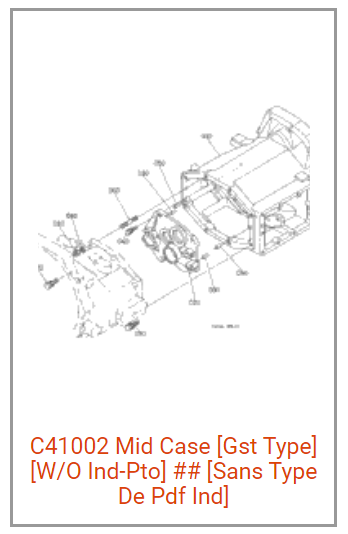

As much as I hate to use parts manuals as a reference, this snip from the parts lookup indicates that the GST models were available w/o ind-pto. It is strange that it does not show a mid case for GST with ind-pto, but the WSM shows in the transmission schematic a reference to supply to the independent pto.
Probably the easiest way to tell is to look at the pto shift cable and what it attaches to. If it connects to a lever and shaft through the side of the case it is nit ind-pto if it attaches to a valve bolted into the case then it is ind-pto.
