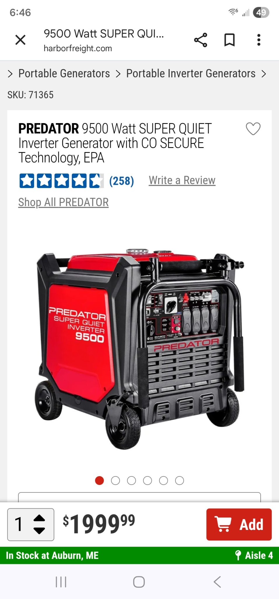

I bought a China Freight one a couple yrs ago after a customer stopped and I had a 15000w China one running while the power was out. It has no idle, its on and flat out blarring loud. It runs everything i own. But I have a monitor gas heater in my shop that has a computer in it. As soon as the 15k is running, it won't run. But with the 9500 inverter it does. I bought it on sale, plus opened a new credit card with them took -$200. More off the price. It came in at $1400. In July of '23. And when you turn the button to off. It shuts off a petcock under the gas tank so the carb runs dry...thoses Chinese using their heads again.

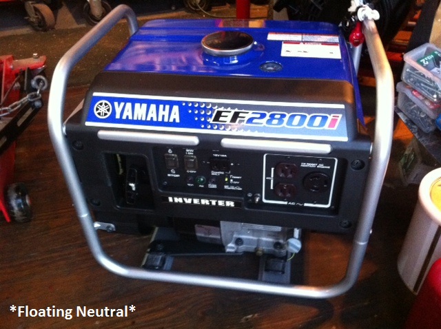

Yamaha is likely the best inverter around...I'm a Honda guy, and I'm sad to say Honda likely makes the second best inverter.
Diesel inverters are the next step up from gas...
Agreed. Love all my Honda stuff, but for the inverter generator went with the Yamaha. It has been absolutely flawless for the last 10 yrs.
