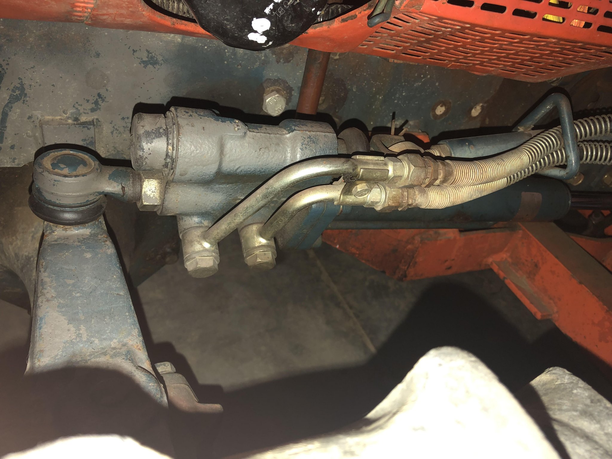

Are you asking D2 Cat for pics of the steering assembly he has available?
yes, to see if it is like mine. Mine was working great and I took it to the dealership to replace a seal on the rear left axle and when I got it back the power steering doesn't work. It steers, but no assist. Before it was smooth and effortless like running on glass.
If it steers but no assist on a B8200 you do not have a bad gearbox. All hydraulic assist in steering is attached to the drag link.
