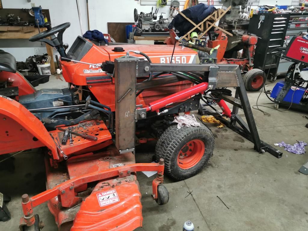

Just wanted to throw some images up here since Facebook is horrid for keeping up information.
Basic front end loader for a Kubota B1550. 72" pin hieght, basically a full copy (dimensions wise) of a BX23 size loader.

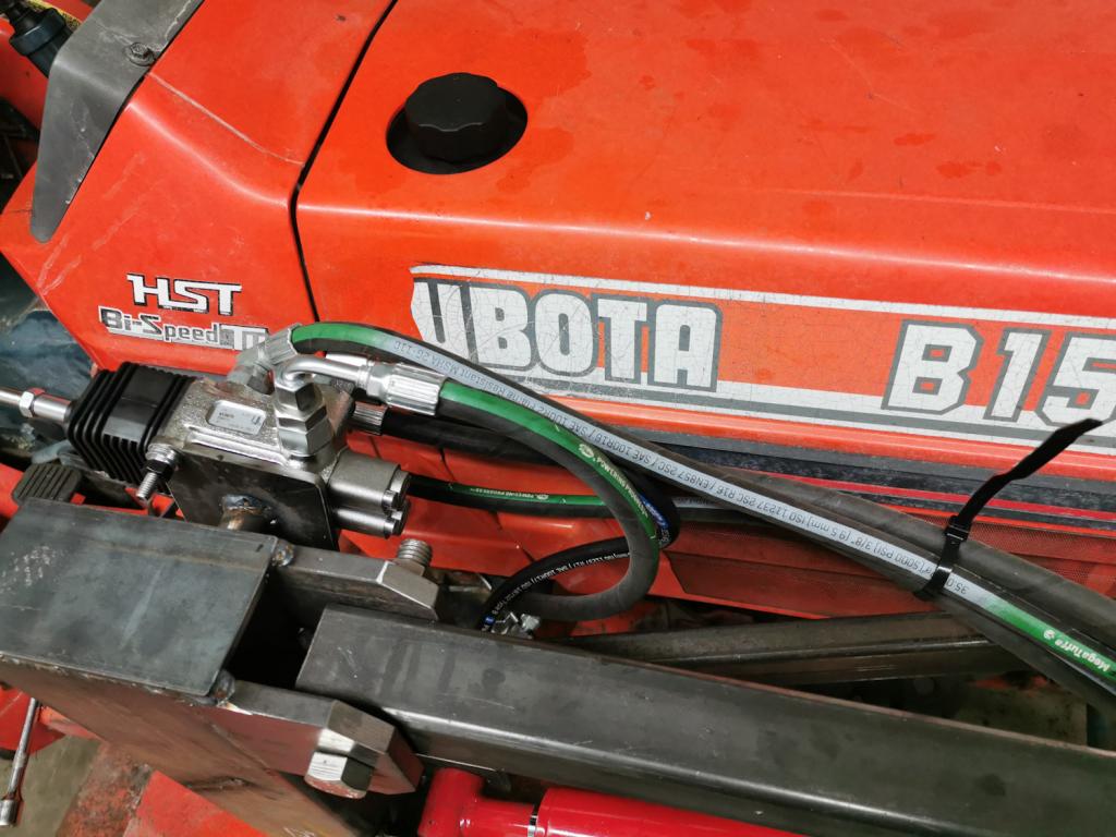

Loader cylinders: 2016 (2" bore 16" stroke) 6orb
Curl cylinder: 2508 (2-1/2" bore 8" stroke) 6orb
Control valve: BM40 2-spool joystick (6/8/10orb)
Tractor side pump fittings: 3/8" BPTM x 3/8" JICM
Hard lines: 3/8" SS .045" wall
Soft lines: 3/8" single braid with 3/8" JICF swivels
Steel needed;
1" pin, 6 pieces all at 4"
3/4" pin, 4 pieces all at 4"
2"x2" 3/16" wall box tube 240" or so
2"x4" 1/8" wall rec tube 80"
3"X5" 3/16" wall rec tube 60"
All brackets made from 1/2" and 3/8" plate
Bumper brackets built from 1/4" plate and 1-1/4" sch40 pipe.
I'll update more and drawings when I get up to it. Making a new style quick connect. I don't like the levers and that, I like simple. 3 slip pins and done. We'll see how it goes.

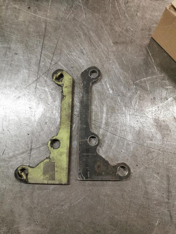

I was going to do a SSQA/quicktach clone but changed my mind. I work with scraps/cutoffs exclusively, I'm super cheap. All the materials are cutoffs and stuff that has hit the scrap bin. I don't buy steel. So I designed the quick attach system I'm going to use going by the materials I have on hand and what I can make. Going to consist of two 1" vertical pins below and a single horizontal 1" pin in the center. I have lots of plate cutoffs and a press brake so I'm going to make it well gusseted and simple to attach. I'll post some pictures of it later.

Be careful not to have the loader positioned too far out in front of the tractor - the distance between the front wheel and the back of the bucket when its flat on the ground should be approximately the same as the front wheel diameter. the further out the bucket is, the more force it applies to the front axle and the less stable the tractor will be when trying to move with a full bucket.
Shawnmc
B1550
Dec 29, 2019
Kirkfield, Canada
Loader is no further out than a LA340. Took all my measurements last time I rented one to do my foundation. Plan was to copy onto a case 444, they translate over to this Kubota easily. Bucket will be 50" wide. Yes I will be doing tie-in plates to the rear diff, and whole goal is to make the mid-mount mower still useable. Still working on how I want to do the quick connect for the main posts, the front upper supports are held with 4- 3/8" bolts. Think I might just weld some 1/4" plate around 3 sides of the main posts and drill some 3/4" pins through.

It is looking good so far. I fabricated a FEL for B8200 last year. One thing to keep in mind is the curl of the bucket. If you can’t un-curl your bucket from a decent height it is hard to pile snow in the winter. I could be wrong, but your curl cylinder seems a bit short in stroke at 8 inches. My two cents.
Shawnmc
B1550
Dec 29, 2019
Kirkfield, Canada
Curl cylinder on a LA340 is 2"x6" stroke.

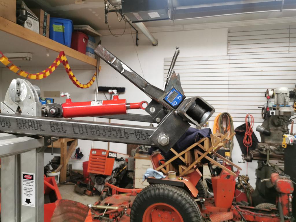

I went with a 8" to get a bit of extra travel, and worked out good. Had to modify the geometry quite a bit to get it where I wanted from the LA340 measurements. Now I have proper tilt at max lift. At 72" pin height I have 51° back, 51° forward. At 52" pin hieght I have 79° tilt forward. I think at those angles I'm equal to what I've read for angles on standard loaders.
Looking at it now maybe I might take 3" out of the upper arm and bring it in a bit closer, anymore and I'll risk the curl cylinder crossmember touching the grill guard.

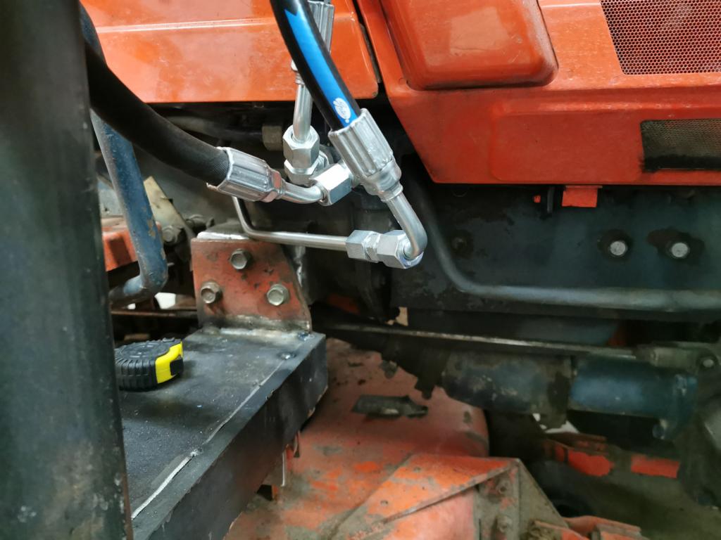

Had all but 1 line made. Was going to go partial hardlined but, I'm lazy. Going to hard line most of my return to tank from the power beyond. Last line into the filler neck for the transmission, going to use a tee so I can still fill fluid without removing everything.
When I built my FEL, I planned on hard lines, I think they look so much neater and professional. However, once I started laying things out I realized just how short the hard lines would have to be, and just how many more fittings and connections that entails, I decided to forego the additional expense and points of potential failure as being impractical on a compact tractor. Function over Form.
Yes that's a big part of it. Instead of 10 hoses you need 20. That's another 20 fittings, and at between $9.99-19.99 per crimp fitting, it gets expensive even faster.
I'm only going to hardlining my return line from the power beyond, made it today from my 3/8" SS tube from the scrap bin. Wasteful people here, brutal, but fruitful.

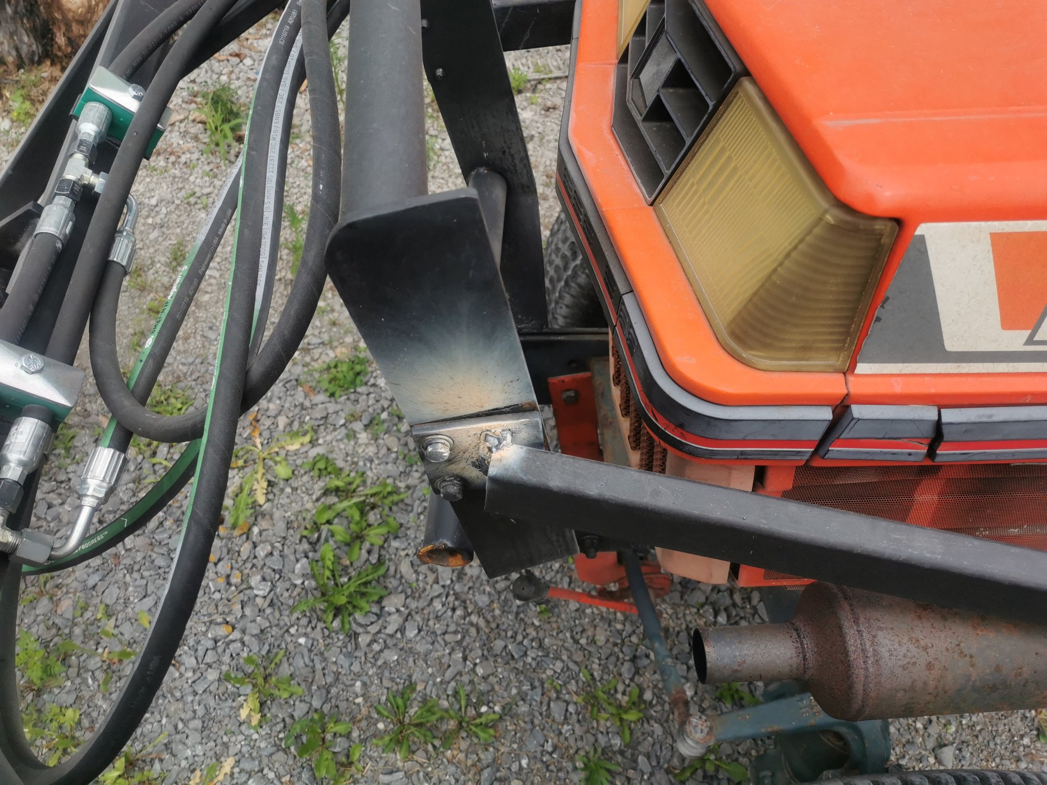

Brackets also made for connecting to the rear diff. Line is on, brackets on, deck back on. About to make the supports from the rear diff brackets to the front towers. Anyone have any pictures of their subframe from a 1550/1750?
