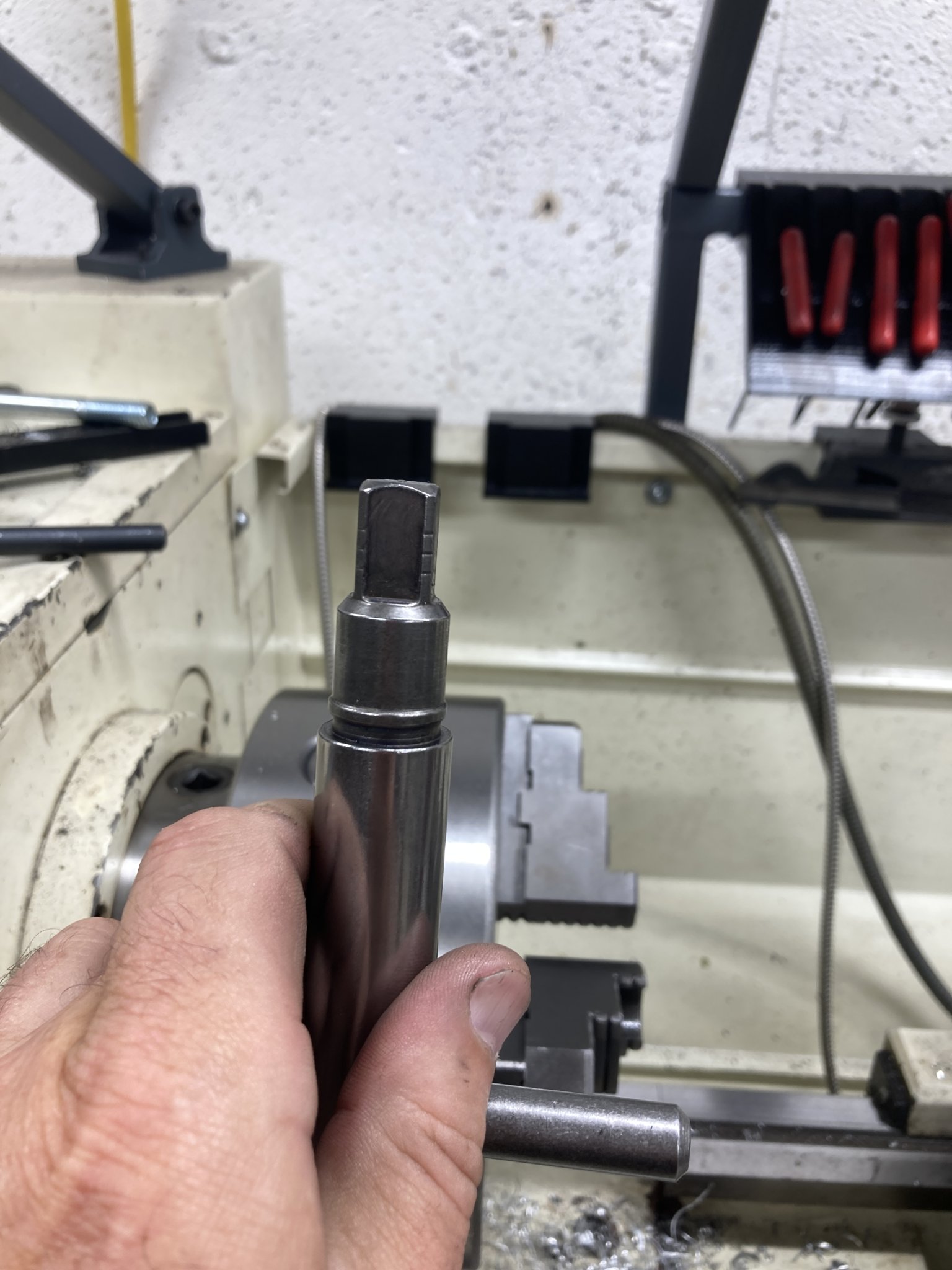

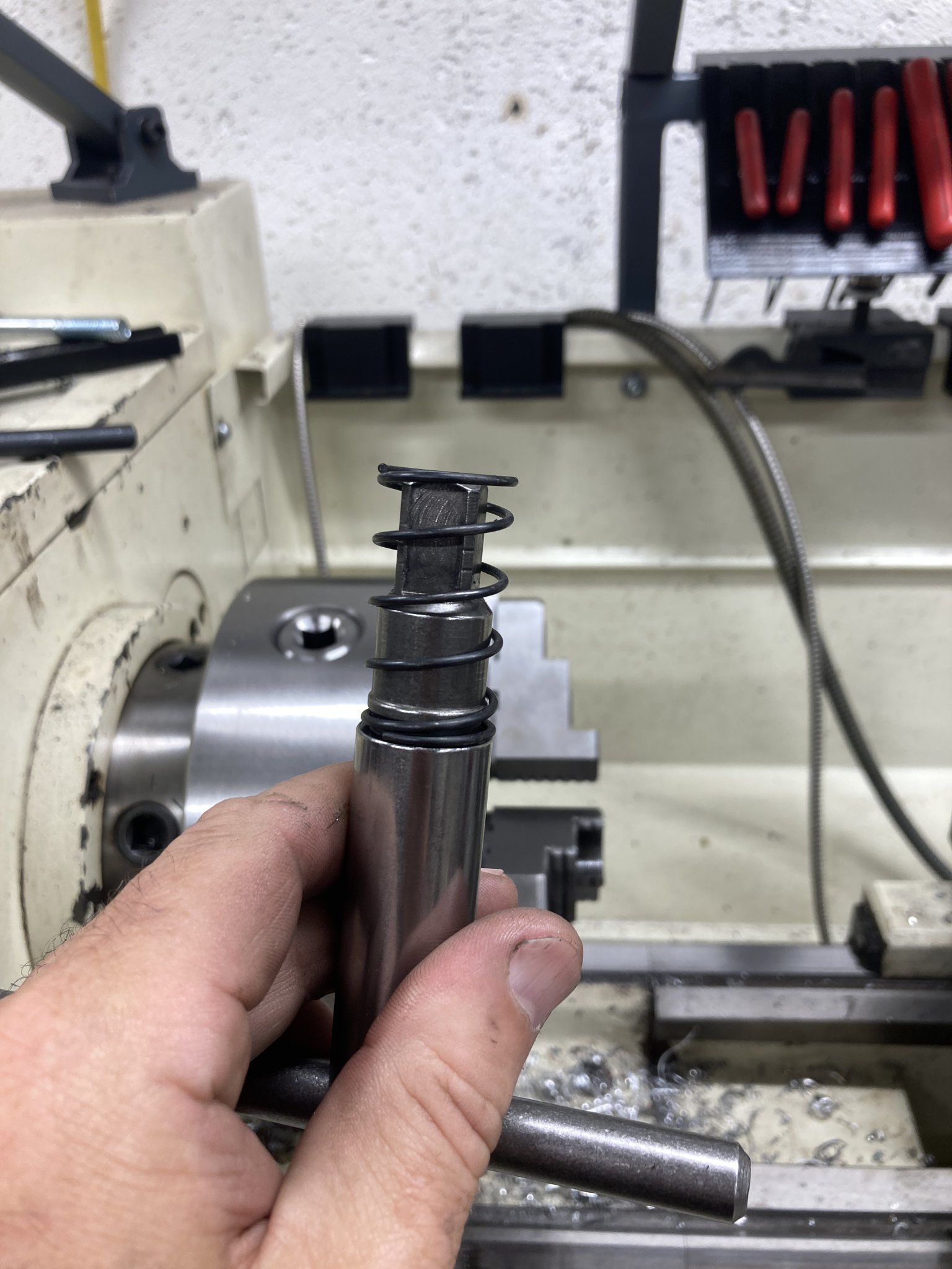

The one "solid thing" I learned was that this " M_______F______g spring" had to go.
That damn spring would shoot that key about 5 feet. I had to pick that thing up off the floor so many times, I was starting to see a "6 pack" develop in my ab's........:giggle:

p.s.: this *#@*#@* spring is the first thing I removed from the key.
p.p.s: the spring takes all the fun out of leaving the key in the chuck and starting the lathe 🤣
