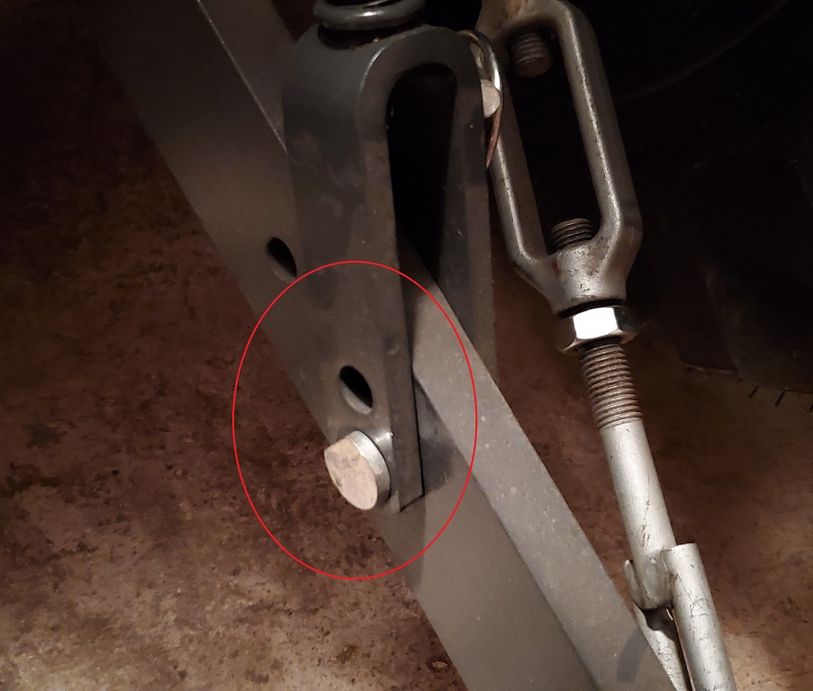

I just noticed something tonight when I was parking my tractor that I had never noticed before. The two vertical lift arms have 2 holes at the bottom where they connect to the left and right swing arms. One hole a little higher than the other. See picture to see what I'm referring to. Common sense suggests this is to allow a slight adjustment to lift height for the 3 point hitch, is that indeed what this is? As you can see in the pic mine is on the bottom hole. By moving it up to the top hole, I could gain a little more ground clearance on the harrow I'm thinking. I just never noticed the 2 separate holes before until tonight....
EDIT: swapped it and took a measurement. On the top hole my quick hitch raised just over 3 inches higher off the ground with the 3pt fully lowered. I wish I knew about this sooner, this will fix my lift height problem with the harrow. As a side note, i also noticed that my turn buckles on both sides are missing the inside nut! Im only approaching 30 hours on this tractor, and those nuts had to be missing from the dealer. -_-

Moving your lift arms to the hole I circled in blue will give you even more lift.

The turn buckles are correct. There is only one nut on each. Speaking of turn buckles you need to either pick up the disk at every turn or purchase the inter connecting pin type Kubota Accessories: Telescopic Stabilizer Kit, Part # L8430. The turn buckles will not take the strain of the disk in a turn for very long.

My L3200 has a nut on each side of the turn buckle for the stabilizers.

Thanks for pointing that out fordtech. I noticed that hole as well and that was my assumption. I think I will have to stop where I am here and see how it goes with just moving to the one hole. When I lift the 3 pt. to the very top now my quick hitch is just like 1 inch from making contact with the back fender/lights of the tractor. I think the 3 inches gained from just moving holes will make a huge difference with the harrow. I didnt know I could make these adjustments to increase lift height so Im really stoked now.
Yea, I think you may be right. I went and googled pictures and videos of other L2501's and it seems many of them are missing that inside bolt. Thats really odd to me, because most all turn buckles Ive seen have a bolt on either side to lock down any movement. Its funny you suggest the telescoping stabilizers because I just bookmarked them over at messicks.com tonight. I plan to get them for Christmas maybe. They are $185 at messicks. Anyone who happens across this now or in the future that may be interested the stabilizers BigG suggested is at this link. Neil even has a video there showing the simple installation. Thanks for the suggestion BigG. I was going to get them just because i hate the turnbuckles, but I hadn't thought that the harrow might actually cause them to fail, but it makes sense. Just another reason to upgrade!

Pic of the stabilizers on mine (off the tractor because the back hoe is installed). Nuts on each end of the turnbuckle. If your talking about the leveling link on the right side lift arm mine only has one nut on top.
I would love the telescoping stabilizers but I don’t know that they would clear the backhoe subframe.

Yep your pictures are what Im used to seeing. Nuts on either side, which is why I thought mine were missing them. If you look at pictures of other L2501's though I find many are also missing the same bolts, ones that would be on the tractor side of the turnbuckles. I really dont get why...It means the turnbuckle could move over time.
