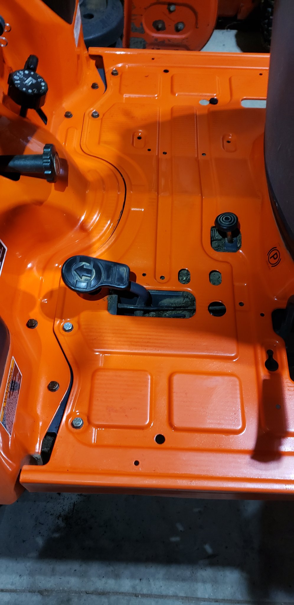

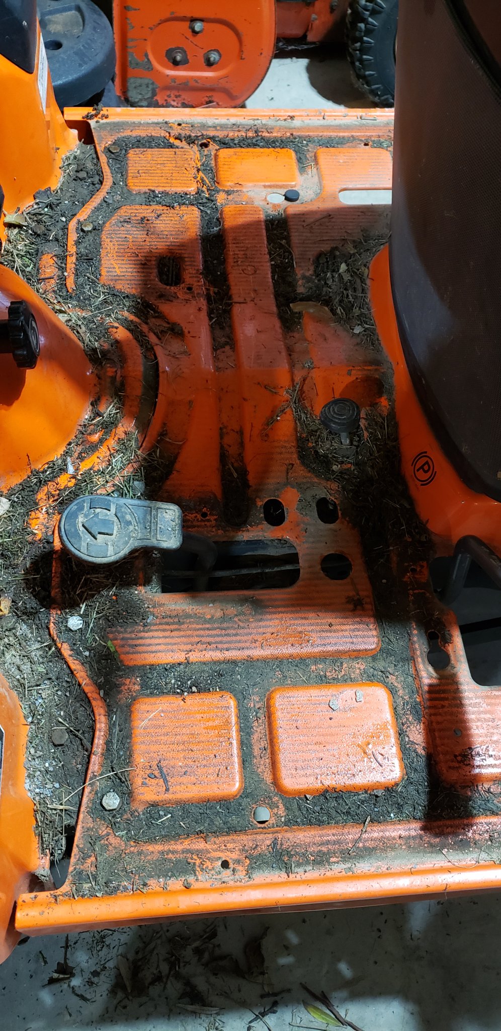

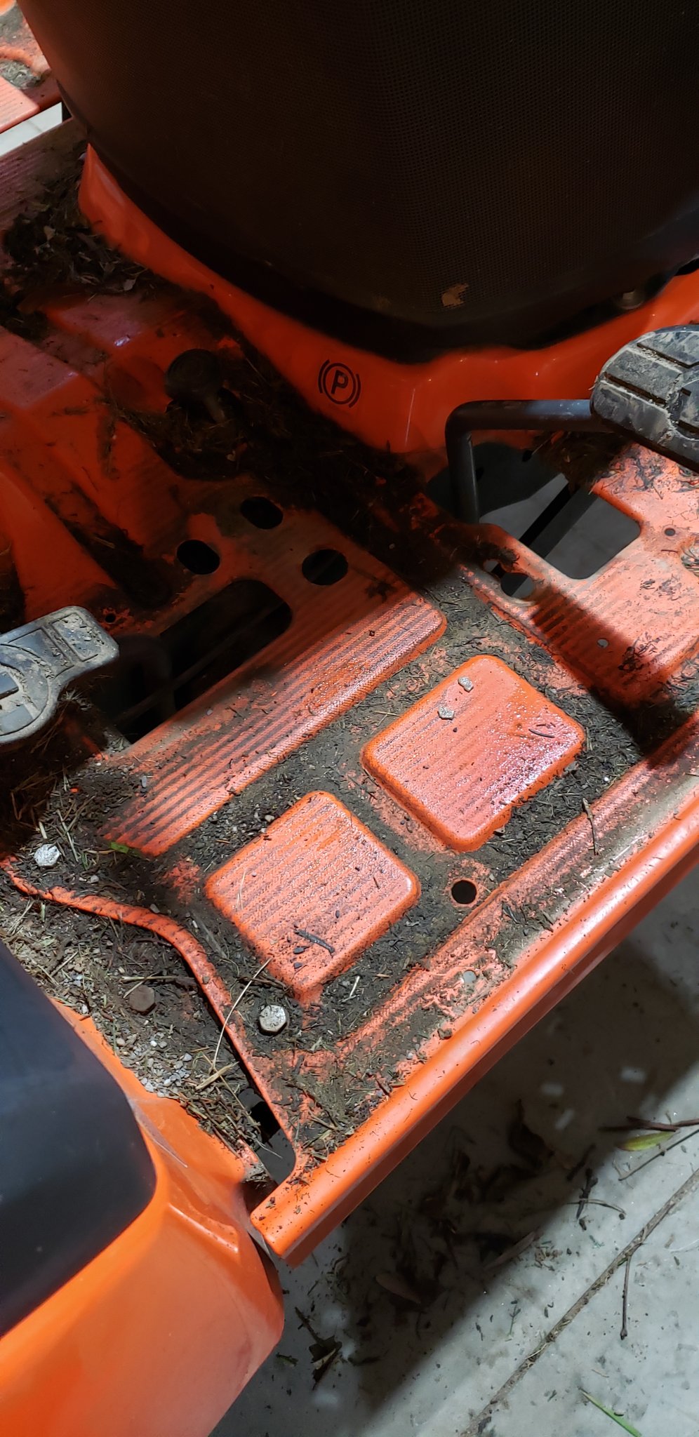

Before I installed my new Original Tractor Cab (see post with the same title) I thought I'd remove the floor mat and clean it up a bit. I did not imagine I'd find all this dirt under there. Something others may want to check to avoid rot.

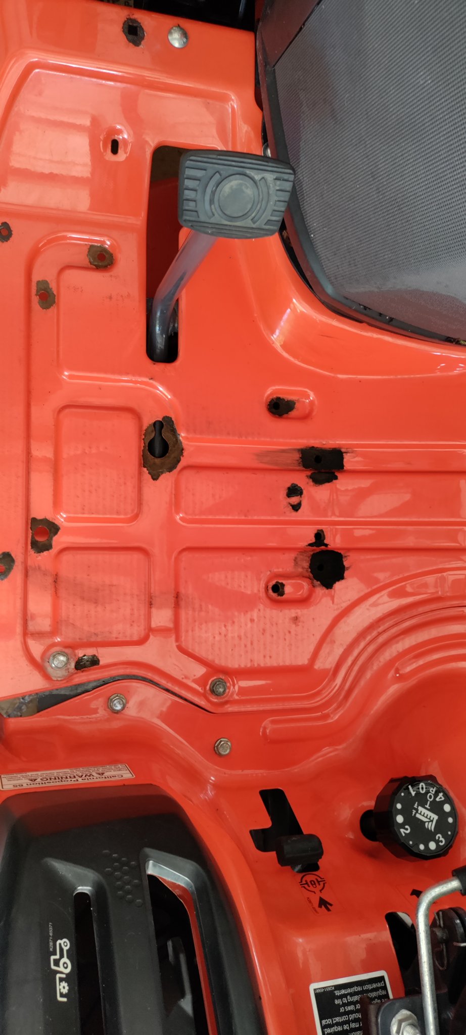

Plenty of corrosion under the rubber mats of my tractor. They are recessed in the sheet metal and I think it is water getting under the rubber that cannot run off any more. I think I will seal them, glue them in once I have removed the rust and made new rubber mats.

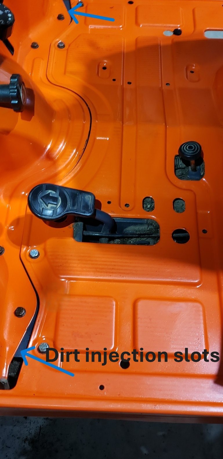

“injection slot”………….that settles the “gender question”…... :ROFLMAO:
Re-read that. "dirt injection slot" still seems to be ambiguous. 🤷‍♂️
