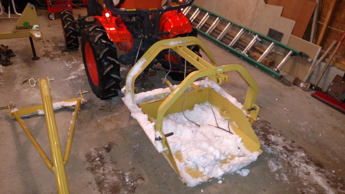

Hey, I have the same tractor (just got it over the winter). Mine came with a scoop, which I wasn't all that interested in to begin with, but after learning how to best use it, it's grown on me a little bit. I'm not sure how they do sizing on them, but here's a picture of it on my tractor (hopefully the picture attaches).
I've found they don't work very well for scooping and stuff. The best way to use them is to lay them on the ground with the top link slightly long so the scoop is tilted back just a little bit. Then you can back up and skim the dirt off the top. As you go back it'll start cutting deeper and deeper, so you'll really have to be on top of that lift lever if you want to keep going backwards. It'll bog down the tractor pretty quick. So really, about 3-4inches deep at, I don't know, 10ft path... That'll make turning the steering wheel very easy. I've got 75lbs hanging off the front bracket of mine and I haven't gotten the front wheels off the ground yet, but I've come darn close.
Keep in mind, I have had about 4 hours of using a scoop. The first hour was trying to figure out how to get dirt into it. Backing into a hill of dirt didn't work. With a smaller bucket I'm sure it'd be easier to get dirt into it, but then again you have to make more trips anyway, so it's a toss-up. Good luck.
