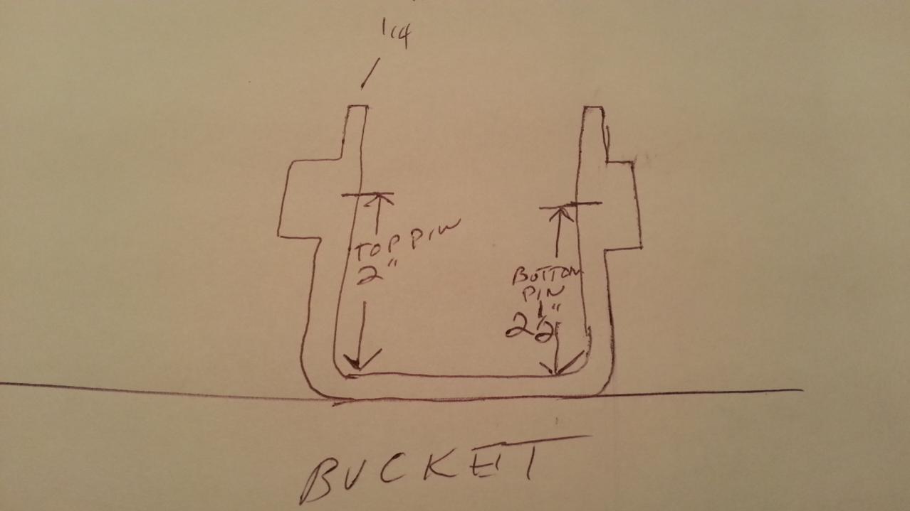

Wow! Thanks Mike. That is an outstanding explanation of the dimensions. I'm heading out to double check against my bucket now. The only thing missing is if you could tell me the distance between the pins and the back of the bucket for both top and bottom.

Here's the other dimensions you wanted.
