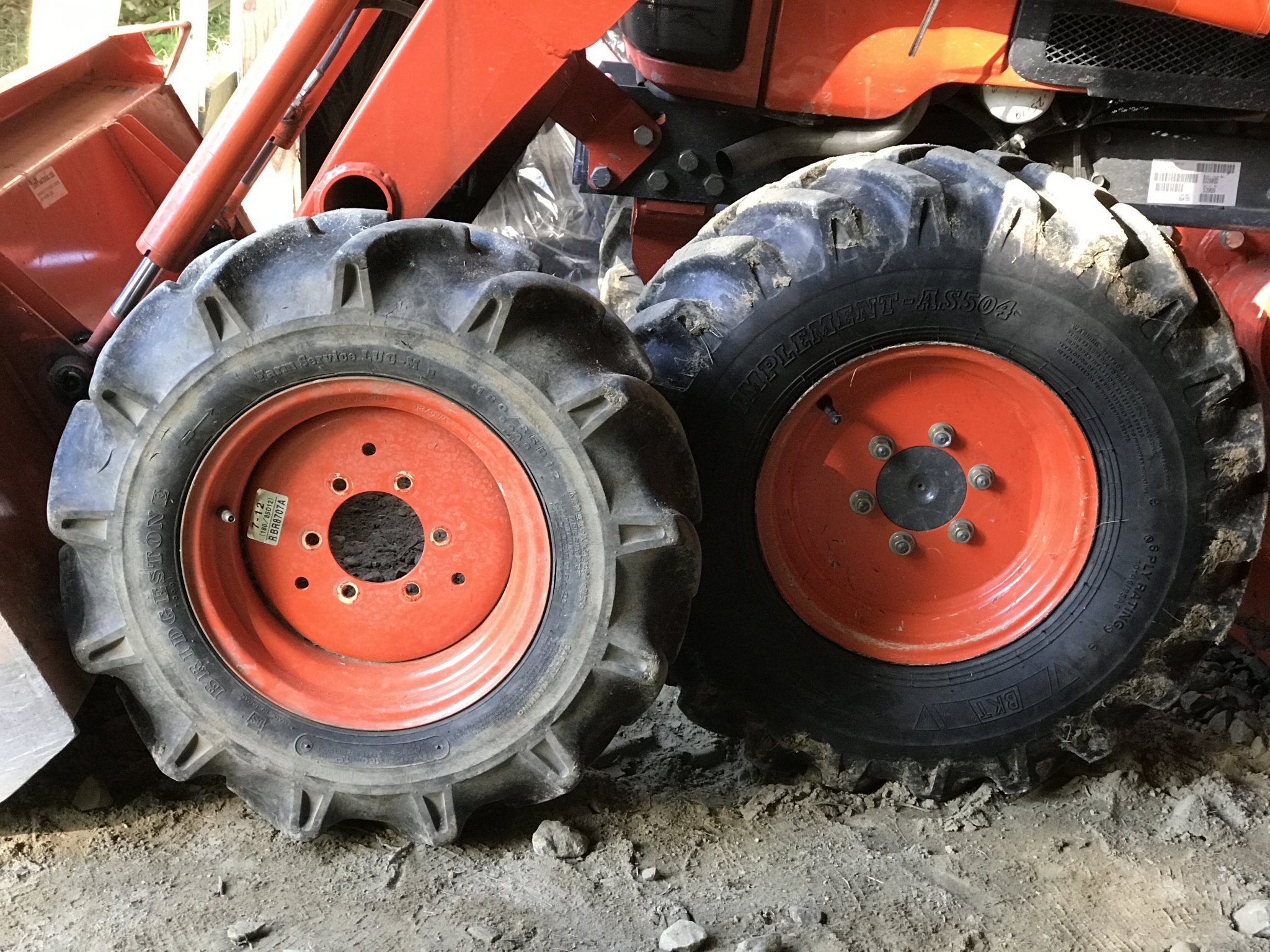

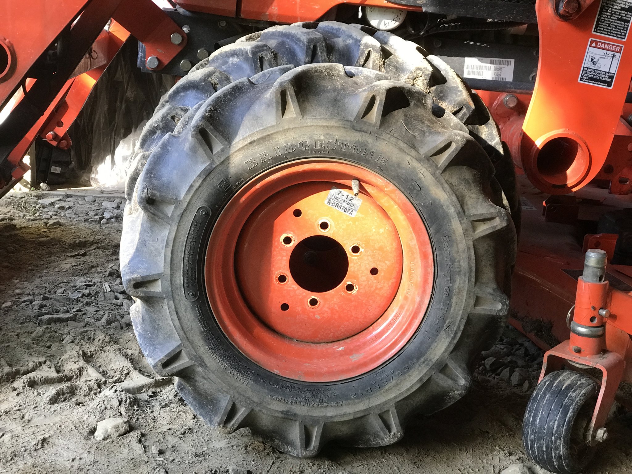

I have a Kubota B3200 I bought new 10 or 12 years ago. The original front rim is 7.00-12 and the tire size is 180/85D -12. This past weekend I found a pair of rims/tires off an older B7800, rim size 7.00-12 and the tire size is also 7.00-12. This set of rims/tires fit perfectly on my tractor. My question is about how much taller the 7.00-12 tire is compared to the original tires. They are approximately 2 inches taller. Question is, will this height difference create or cause problems/damage to the front end or rear for that matter?????
The tire on the left is the original.

at 2" taller..... that is going to be a hellva difference in RC..... which will not make the drivetrain very happy!
If you use them - I would not use in 4wd!!!
Typically in all 4wd scenarios - the fronts "pull" the rears a bit, in your case it is gonna drag them!!!
I would tread lightly here!
