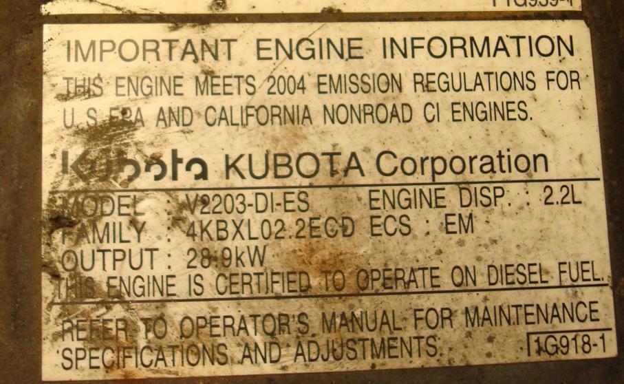

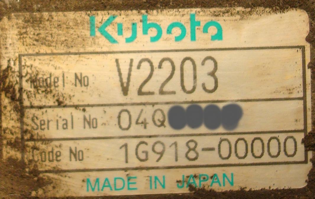

I am looking into repowering my retired US Navy whaleboat with a Kubota V2203 134DI. The engine was used as a compressor by Carrier Refrigeration company. This engine was removed from a semi refrigeration trailer. The state of Calif does not allow them on their roads. There are several versions of the engine with different horsepower and rpm ratings. Carrier calls them V2203L-DI-E3B-CT-1 or CTD-2, or CTD-3 all the way up to CTD-6. The rpm ratings are from 1700 rpm to 2200 rpm and the horsepower values are mostly in the 32 to 36 hp range. Is these all the same engines as the factory V2203-M-E3B and just set to run at a set speed? Why all the differences?
