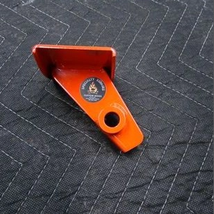

I remember seeing this on their YouTube channel and thought about it.. I thought it was a little pricey so I thought I could live without it. Come to find out this may be exactly what I need! I tried normally pressing down on the lever with some decent amount of pressure. I’m pretty good about knowing the limits of mechanical items and I was having to put a LOT of pressure on this as I was slowly going forward. I could almost feel it trying to do something so I went with even more pressure and low and behold it moved, more pressure and it finally started to go and then slowly went down and locked in.
Each time I tried it, it acted this way, so now I’m thinking it just needs a little more leverage. That little lever it comes with makes it feel like you’re going to bend or break something. I guess they made it small trying to keep the platform more open.
So I guess I was being too easy on it.. Thanks again guys!
