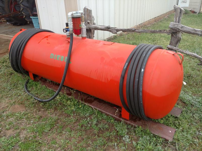

Gives me something new to worry about…. I have a 160 gal storage tank that sits out in the sun year round and gets pretty warm here in Tx. I only refill it about once a year and run the fuel in 3 different machines without any issues. (I do treat it with Biobor JF and with Diesel Stabil. Haven’t worried about for several years …until now.)

Does your filter I see on your tank eliminate water? I have a water filter on my bulk tank and both my tractor and excavator have never had water in their on board water separator. Before putting fuel into my machines, I run the fuel back into the tank to flush any crap out of the nozzle. Just takes a few seconds.
I use a "winter grade" diesel year round. It cost a bit more but I don't use a lot. My diesel can be in the bulk tank for years with never an issue.

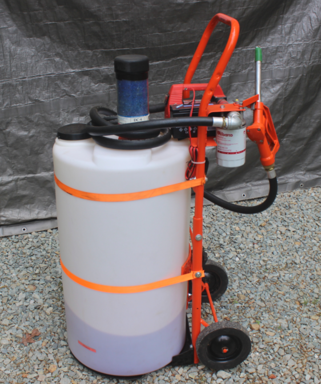

That's a nice set-up. Is that basically a LP tank that you can pressurize to push the Diesel out?
That's a good observation. I didn't even pick up on the lack of a pump.
Mine has a 12V pump connected to a deep cycle battery kept on a solar maintainer.
That’s exactly what it is….a propane tank which i pressurize with shop air (Ten psi is all you want or the handle will “jump” out of your hands.) The dip-tube pulls fuel from about 2” above the bottom and the tank has a sump-drain I installed at it’s lowest point. Never found any water in it or in the filter.
i’ll try to find the original thread where I discussed how I built it.
Here it is: https://www.orangetractortalks.com/...your-refueling-setup.29684/page-7#post-247691

That’s exactly what it is….a propane tank which i pressurize with shop air...
I've thought about that for years - seems like a good idea. I like that, since the tank is totally airtight, there will be no atmospheric 'breathing' that over time would draw in moisture.
