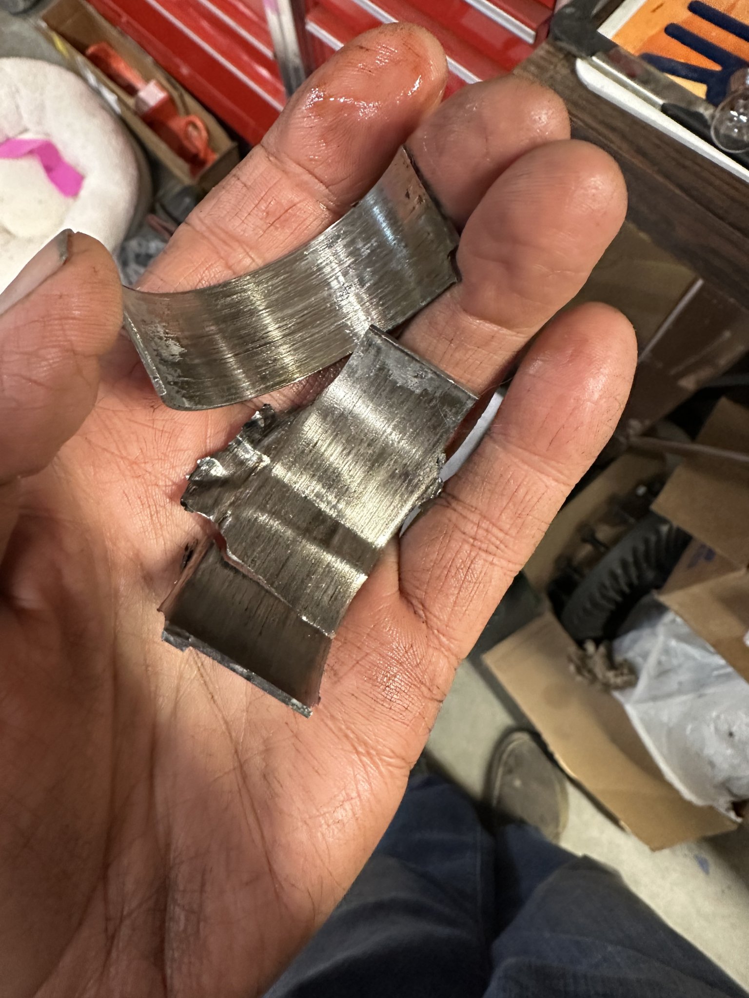

Based on recent personal experience, I’d be cautious if you are having injector timing/delivery problems, it can be destructive to your motor. My L2850 luckily had maintenance records from the previous owner and I read in the dealer notes that number 1 injector had very low “crack pressure” , so they replaced injector with oem. When I bought this tractor, it was not firing completely on number 1 and it was smoking. Compression on #1 was low, so I tore it down. I found that the number 1 rod bearing was destroyed, most likely from way too advanced/too much fuel delivery on number 1. Tons of soot in there too. Didn’t knock, ran great, started easy, but smoked some and I was well on my way to a rod hanging out the side of the block. Luckily crank journals are hardened so I was able to clean up the #1 journal. If the knock gets worse, I’d pull the pan and check the rod bearings.
