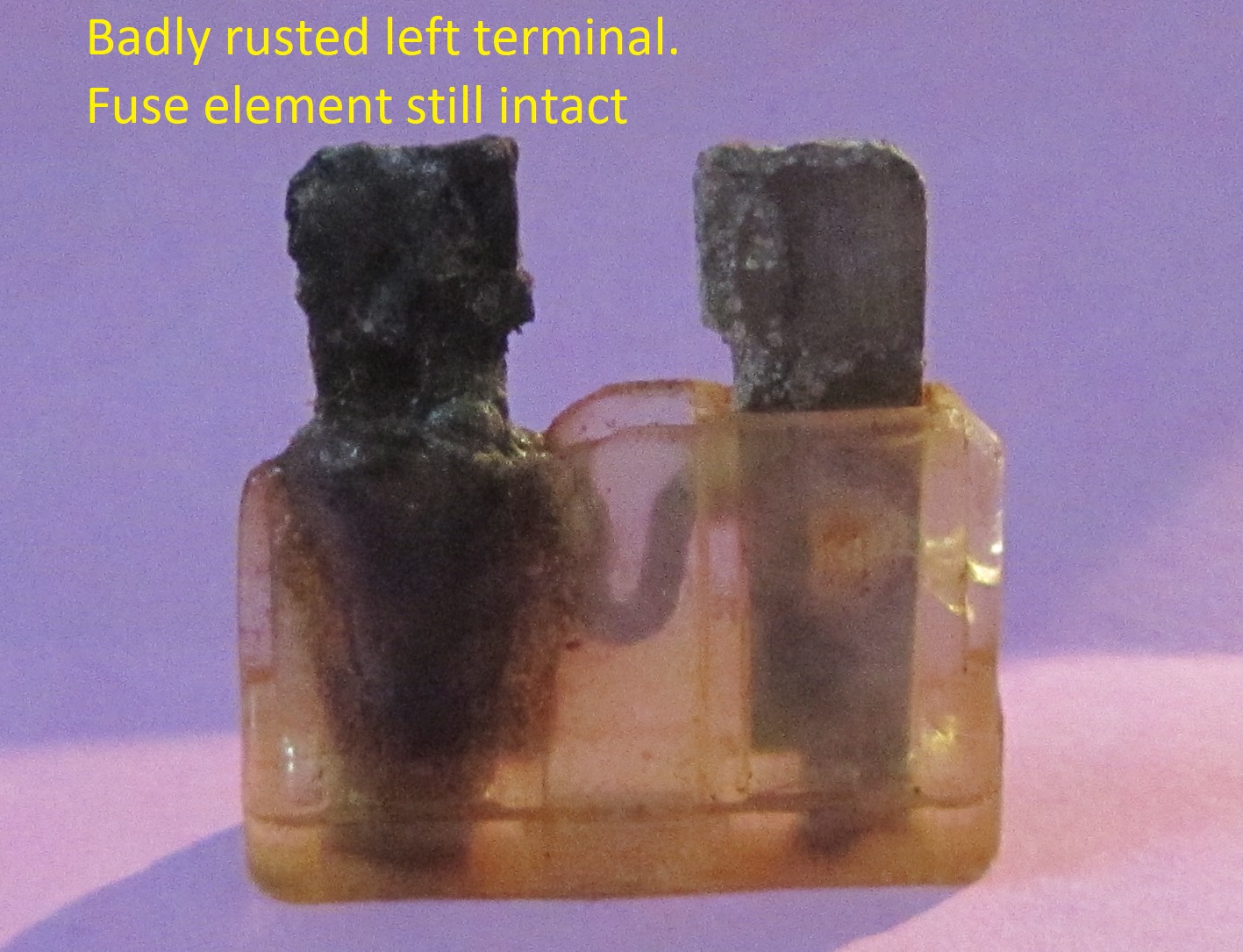

I first need to thank Henro for reminding me the BX1800 2200 wiring diagram covers two different engines and each engine is controlled completely differently.
On the BX-2200 engine (D-905) the engine stop solenoid needs to be powered for the engine to run.
On the machine in question, with the key in the ON position you should verify power to the engine stop solenoid using a 12 volt test light.
If there is no power to the solenoid it will never start.
A blown fuse would be the first thing to check if there is no power.
Do not just look at the fuse but pull each one out for examination and this photo will show.
This fuse tests good but does not conduct power.
Dave
