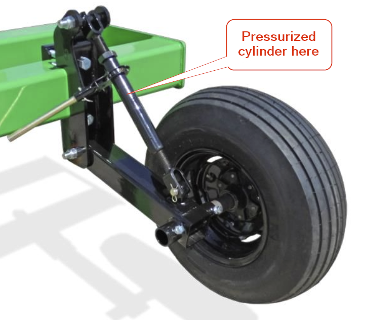

Surplus Center is one place. A double acting cylinder would work , just need a filter on the upper port.
You could use air shocks for vehicles mounted upside down. Random example-
