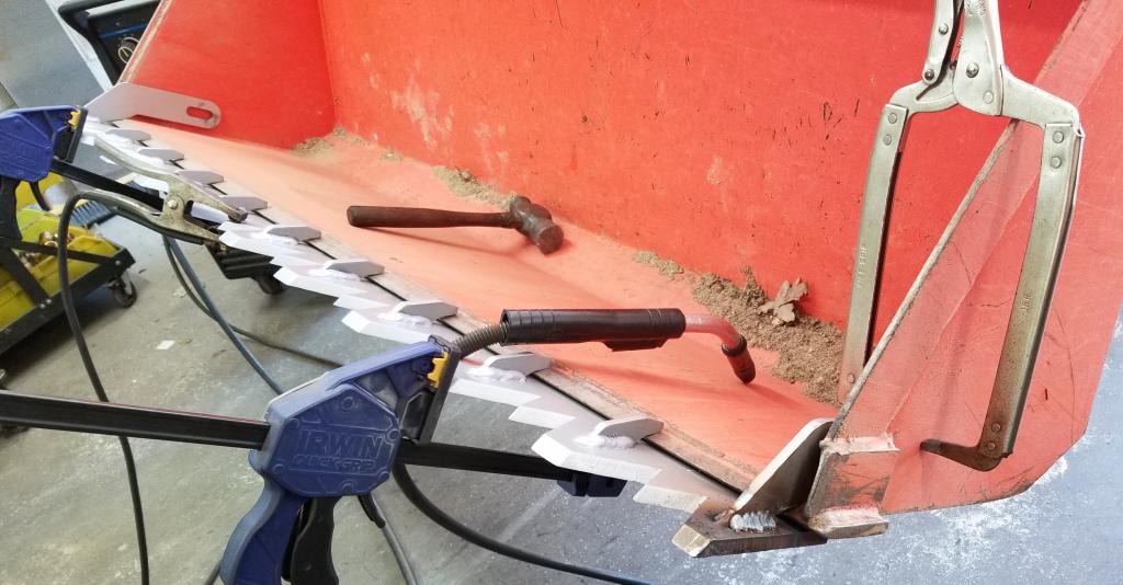

Thanks to the member who told me the photo was to big. I cropped it.
Nicely done!! How hard was it to trim the main cutting edge to length? Plasma cutter?
david
Yes , marked it and plasma'ed the end off. Then the attachment tab. Lined everything up and rewelded.
If you hate snakes like I do. The piranha bar is an excellent 'chopper' , I've been bush hogging and see one of those slimy bastards running off. I tilt the bucket down quick and go chop chop chop with the bar....up and down...chop chop chop...Yup. Then back to mowing.
I figured as much by the looks of it and knowing that it supposedly is hardened material. I have an older Hypertherm plasma cutter.

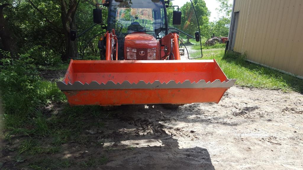

Got my bar today. Going to put it on tomorrow night after work. And test it out Saturday morning

Nice easy install, works GREAT! The only complaint I have is if I have the bucket on, I can't use my grapple. Yet, the toothbar did a wonderful job digging and cutting out brush. I then went back and switched to the grapple to clean up the mess I made.
