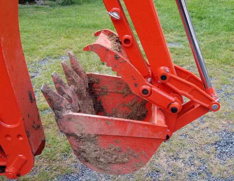

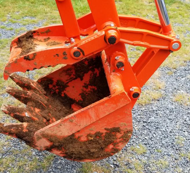

I bought a new L3301 from my local dealer. Got a BH77 to go with it and opted for the mechanical thumb. It took me a couple days to notice the pivot was mounted in the wrong spot.
TedBull
L3301, LA525, BH77, 48" forks, 60" Brush hog. Titan stump bucket.
Jun 16, 2019
Snohomish, WA
I called the dealer on it. The service manager questioned it, asking me how I know it is wrong. "Well, becuase it cant adjust becuase it pivots into the boom."
I corrected it myself. But then noticed they had put the wrong pin in the guide link as well. Now I have to drive down there and convince these knuckleheads to give me the correct pin.

Yup. Sho 'nuff

Did they possibly move the proper lower pin up to the top of the thumb?
