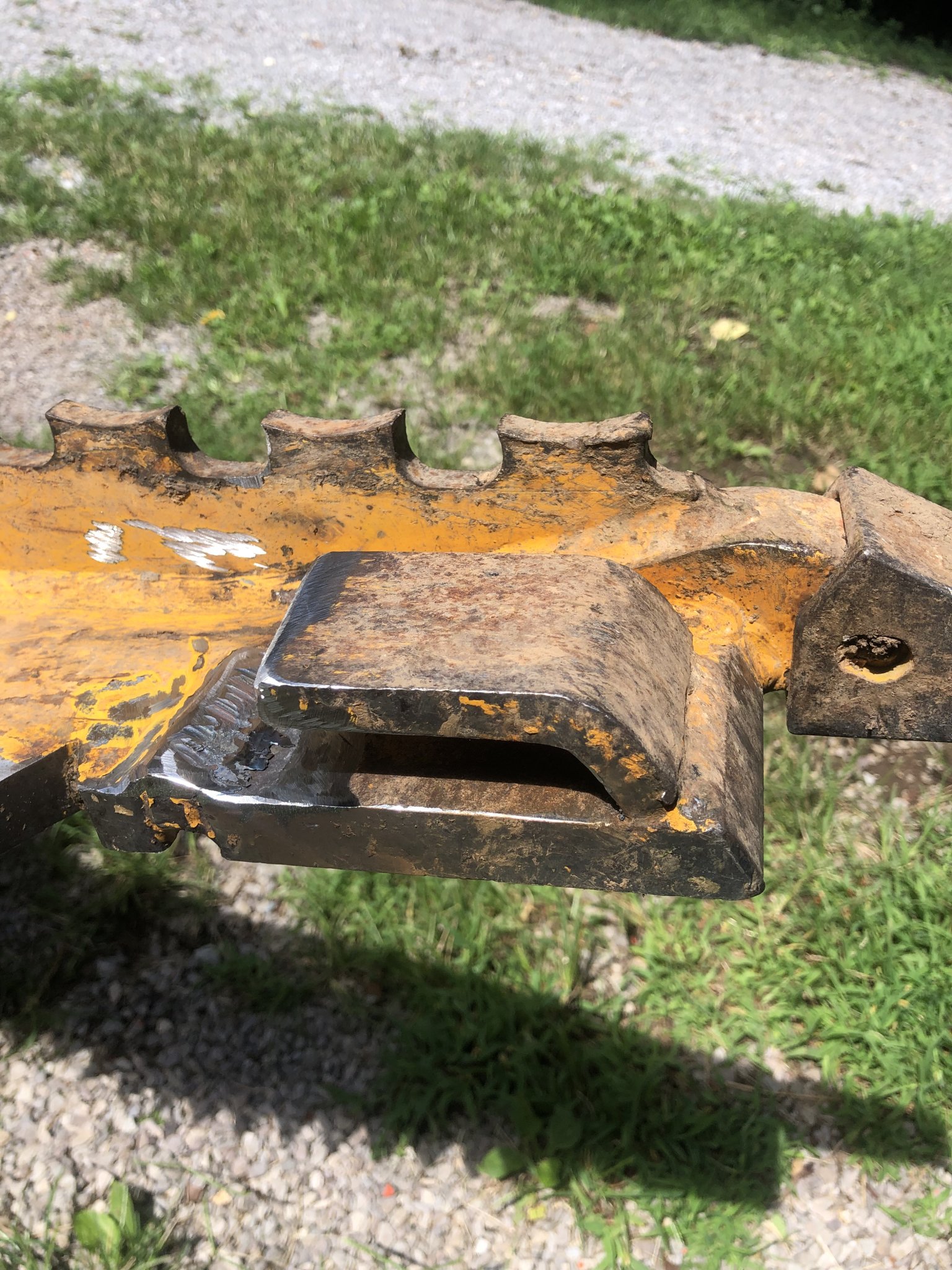

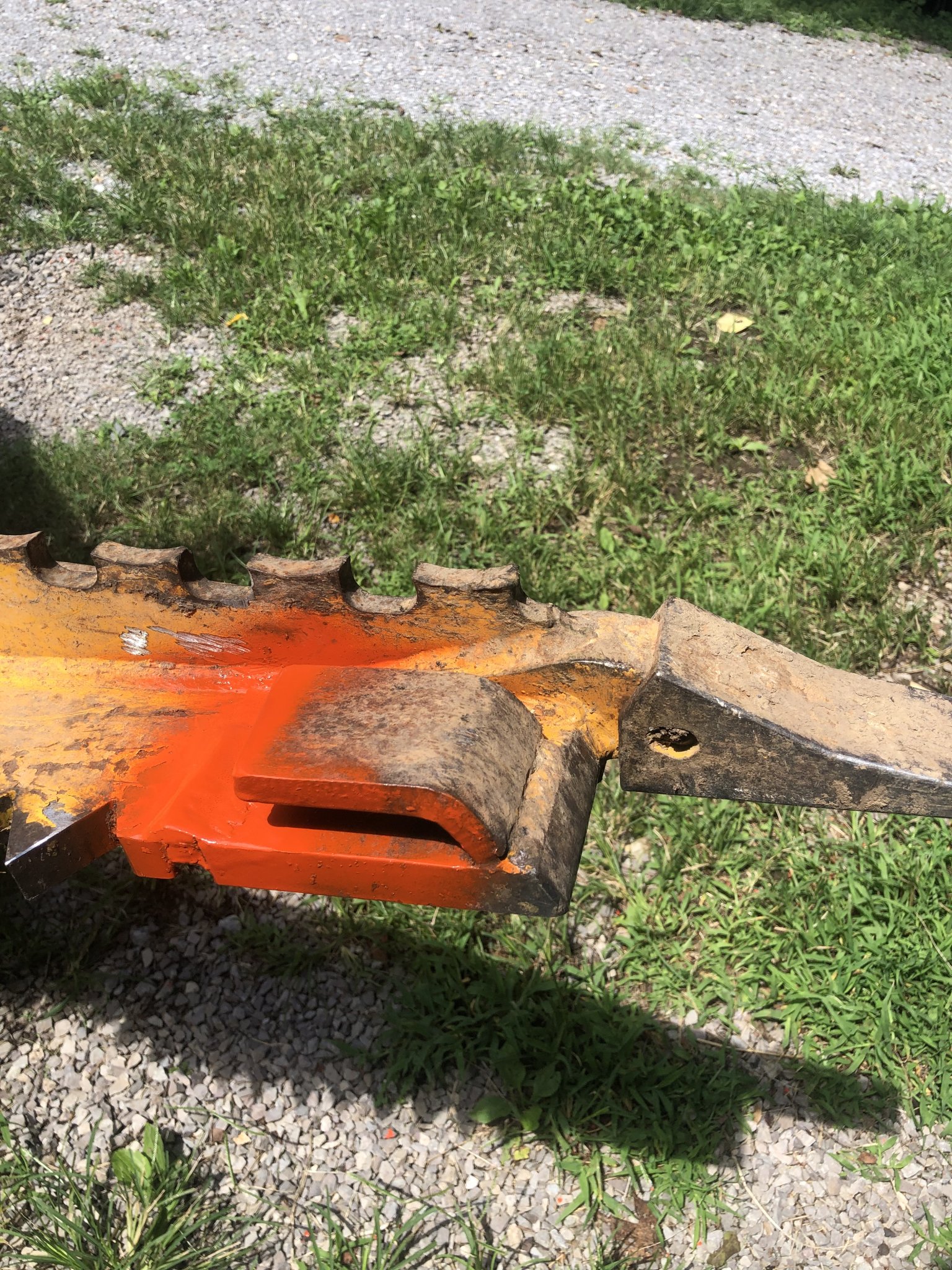

The tines lock together with a tab and pocket for excavating. Problem is that pocket can get packed with dirt, gravel and wood enough to keep the tines from fully closing. Hammer and big screwdriver to clear. Newer models have different design to help eliminate this problem. Contacted Danuser and they said I could cut one side of the pocket to match their current design. So after many years of use I did.
Cleared the impaction. Two cuts with plasma cutter. A little grinding. Paint and done in 5 minutes.
