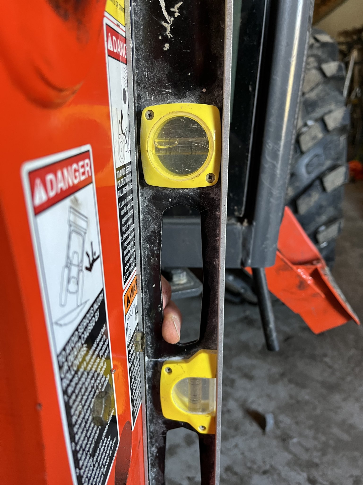

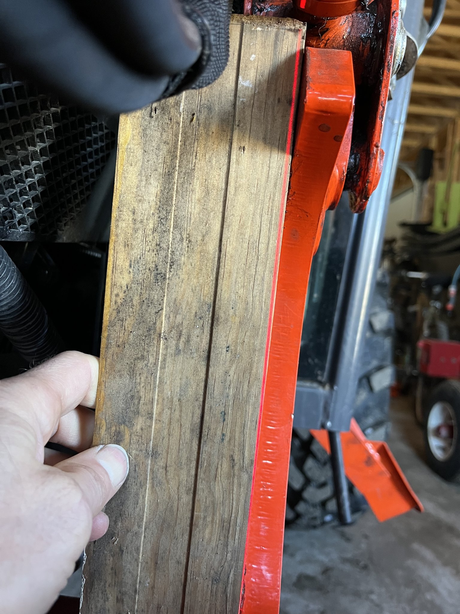

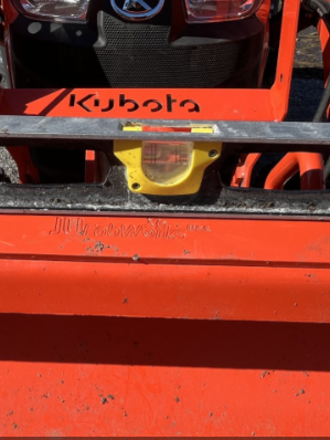

In the two pictures the bubble seems to be much further off on one picture than the other. Why the difference? One picture says leave it alone, the other says we are off too much.
If you decide to twist the frame it I'd loosen the mounting bolts prior. It could be the loader has been off a bit for a long time and the bolts were not tight enough and the loader moved and made the difference much more obvious to you.
If the steel is actually bent somewhere, bending it back will not do much good, you have a weak spot if that is the case.
Thank you for your input. The 4' level was placed on the loader arms closer to the cab. The 2' level was placed directly on the bucket. The level is off more the farther away from the loader arm pins.

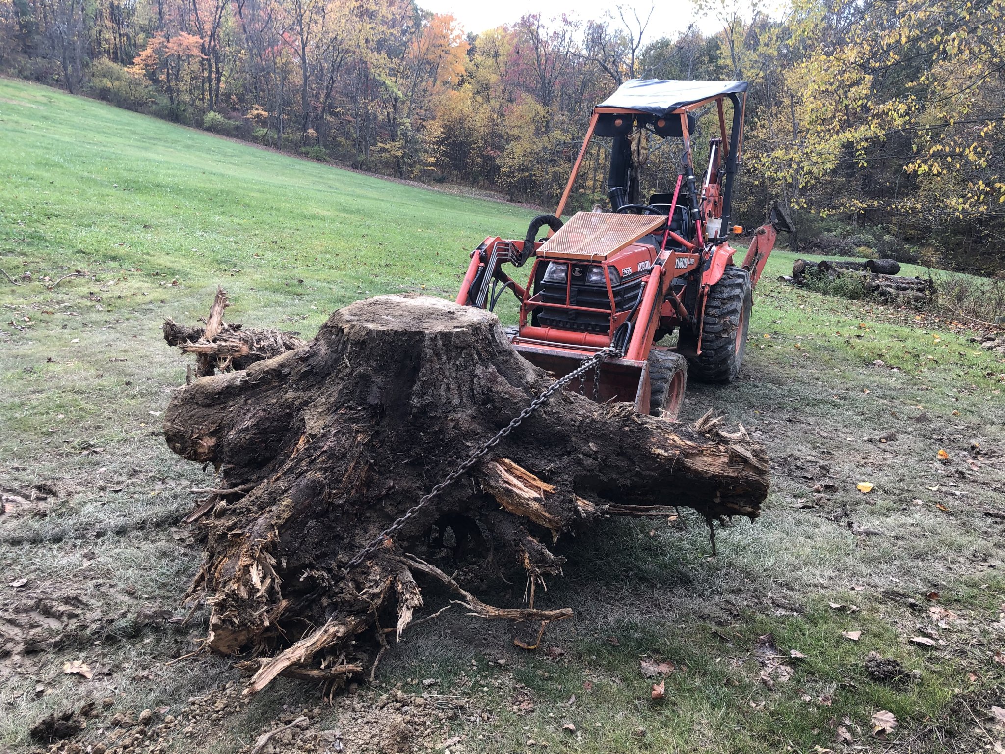

It wasn't the lift. I believe it was the transporting (50') across a short distance that did the damage. From this point forward, I won't be transporting using the tractor. I would lift the log, place on a trailer or log skidder then transport.
This is likely. I feel like Neil from Messicks had a video on this, if you get any speed up transporting it can put a surprising amount of force on the loader. You may not have an undersized tractor - if it could lift the logs then it's enough tractor. You may just have done a thing with it that really compounds the forces it's under. If you can transport in another way, you might be fine ongoing.
Logs onto a trailer, tow a trailer full of logs, unload at the other end. Probably more efficient too.

Here’s one example. I could only lift this stump about 3 inches off the ground, but it was enough that I was able to move it where I wanted to dump it.
