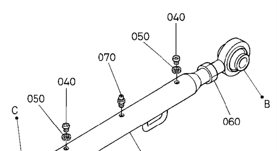

I came home from a business trip to find out that my wife allowed my BIL to use my LX2610 while I was away. I didn't think much of it until I went to connect my BB this morning and found damage to the top link. More specifically, the adjustable threaded piece on the implement side of the top link (item B in the diagram below) was bent.
The part just threads into the top link assembly so I assume that I can just order that specific part but I am not able to find a part number for it. Does anyone happen to know the part number or where I can order it from?

Don't believe it's serviced separately.
One can only wonder how someone could damage it?
Pretty common problem and places like TSC sell replacement ends but they are inch size so not sure they will fit a Kubota OEM top.link.

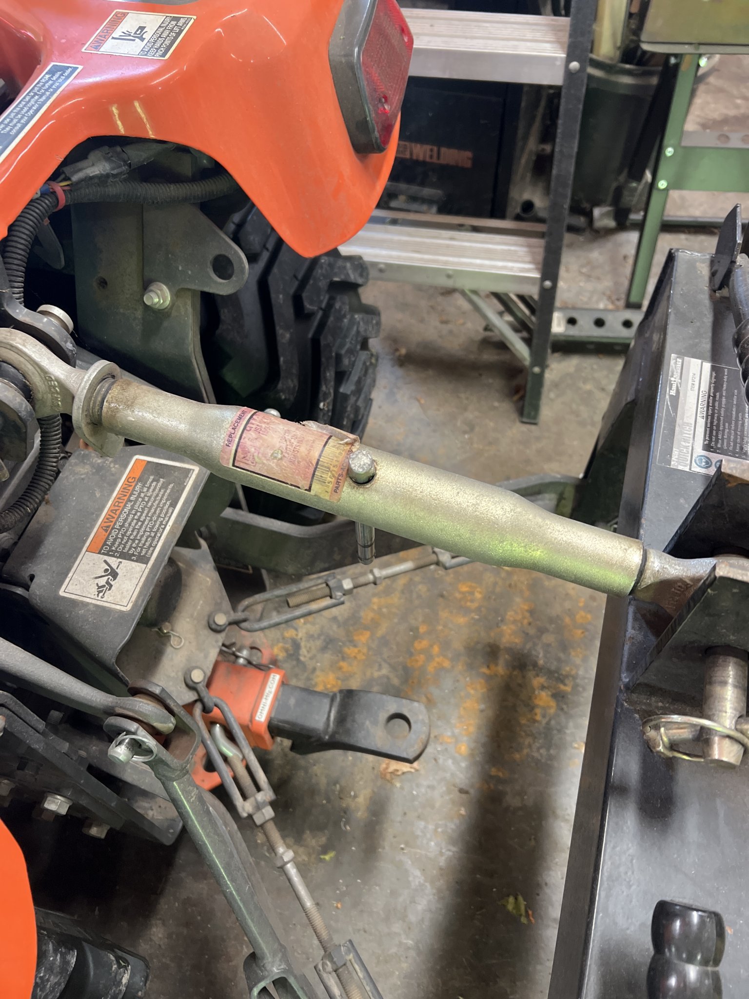

Never been a fan of the Kubota OEM top link myself.
I have a couple aftermarket varieties. Just like them better.
9,999
6,795
I bent mine with the rops down and raising the 3pt with my QH attached. Rural king didn’t fit (too wide). I ended up with one from my dealer for around 25 bucks
When I've bought aftermarket, I just ground the wider flange on the ball off. They were too wide also.

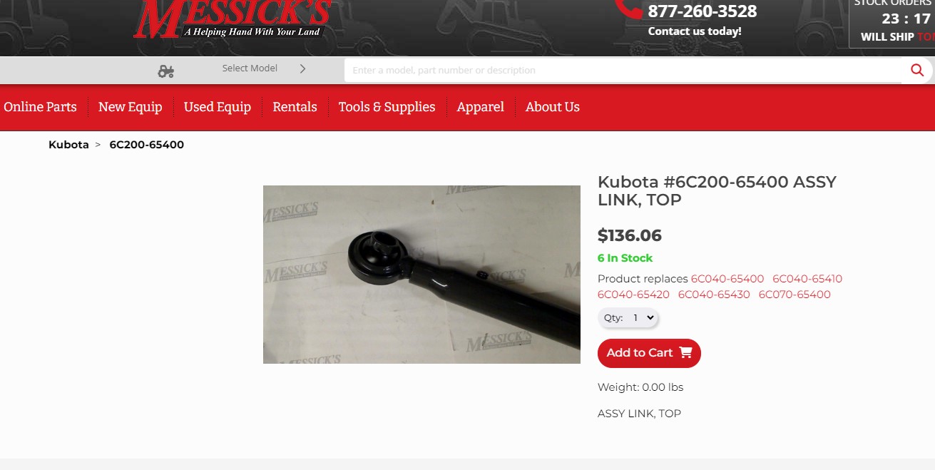

Not sure what TSC, etc. get for them anymore, but Kubota is getting quite proud of the OEM.

I went through this on my tractor. My B2650 and your LX2610 use the same 6C200-65400 top link. In my case, the Phillips head screws cover an access point that is used to mar the threads. The threads have been flattened and the end fittings will not come out. I suppose that I could have put it in a vice and forced it, but the threads would have been ruined. I got an after market top link that was an exact match. Try these people. Their part number is E-6C200-65400. The price is $35.00.

John - - this is the type I prefer. Drive the rod threw with hammer when you get one. You’ll want a Category 1 Top Link.
Most Farm stores have them of various lengths, often with the rod not installed. Measure your barrel. If the flanges/ears on the balls are too wide for your mounts, a few minutes with a grinder will fix that.
A little Fluid Film once a year is plenty. Doesn’t collect dirt like oil or grease.
