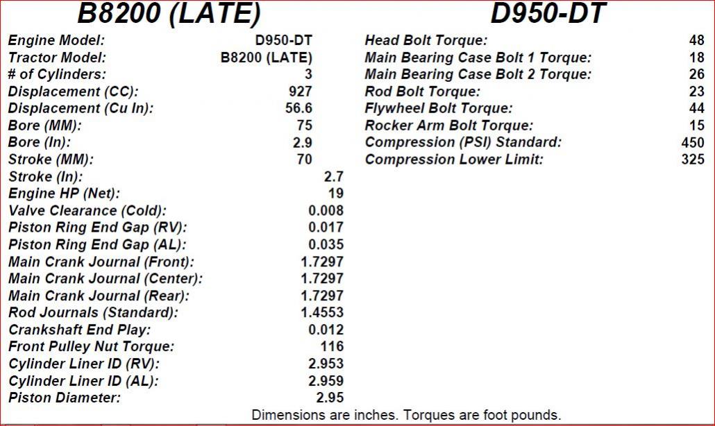

Anyone know what the ring gap specs are for a D950? Looking for factory gap and allowable limit. Thanks
