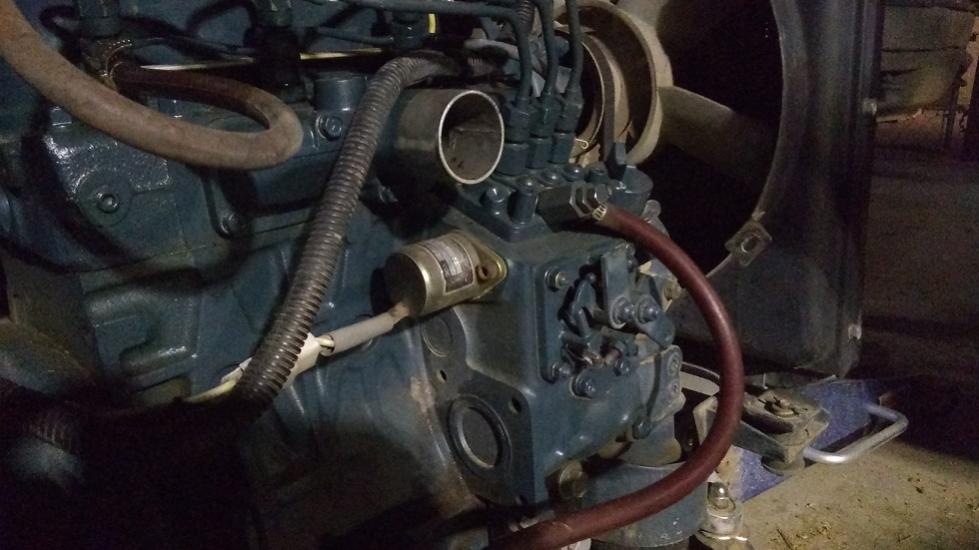

I am posting the photo for the owner of the Kubota powered Genset.
Below is his message
I'm attaching a picture of my Kubota powered generator. It was pulled out of a portable light plant/stand. As for controls, it didn't have any so I improvised with a key switch and separate start push button. The key in the "on" position provides +12 volts to the glow plugs and the hold in side of the fuel shut off solenoid, as well as the switched side of the alternator. The push button for starter provides +12 volts to the pull in coil of the fuel shut off solenoid via the +12 volts to the starter solenoid. I checked the fuel shut off solenoid for it's correct function and it is pulling in when starter is activated and does not release till the key switch is turned off. I think the only thing I haven't checked is compression.
My other question would be, when I'm trying to start it and with a volt meter reading my battery voltage, I'm seeing the voltage drop from 12.1 to 9.3 volts. Is that going to be an issue with the glow plugs?
The picture I've sent shows the levers on the side of the fuel injector pump, and I was wondering if the one that is fixed would be the throttle so to say that you mentioned opening up while trying to bleed? The other lever forward of it does move but I have no idea what it does.
Thanks for any help you can send my way,
Perhaps someone will recognize the engine and can advise re the levers on the injection pump. Further, what model of tractor this engine may have been used in. I see B1700 using the D905 engine.
I am suggesting the owner try and find engine identification and provide it here.
The wiring for the GP's seems wrong as far as being ON when the key switch is ON. In this configuration the GP's may have failed if ON too long.
