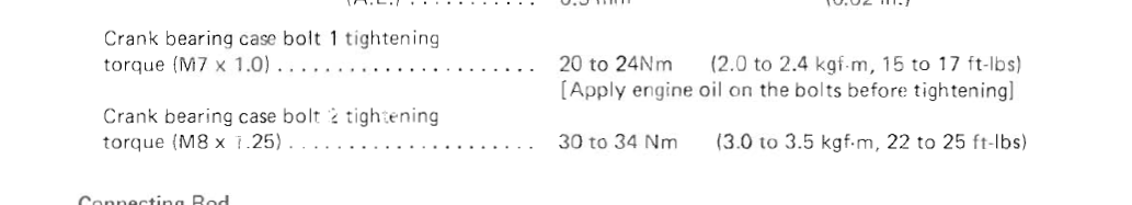

I am reassembling my B7100 with the D750 engine. I am installing the original bolts on the (3) main crankshaft carrier bearings and torquing to 23 ft. lbs. Im using a "click type" torque wrench correctly set to 23# but it feels like the bolts are stretching. I switched to a beam type torque wrench and it feels like they are still stretching and I cannot reach the 23 ft lb mark on the scale. I stopped because this doesn't feel right and I dont want to snap a bolt.

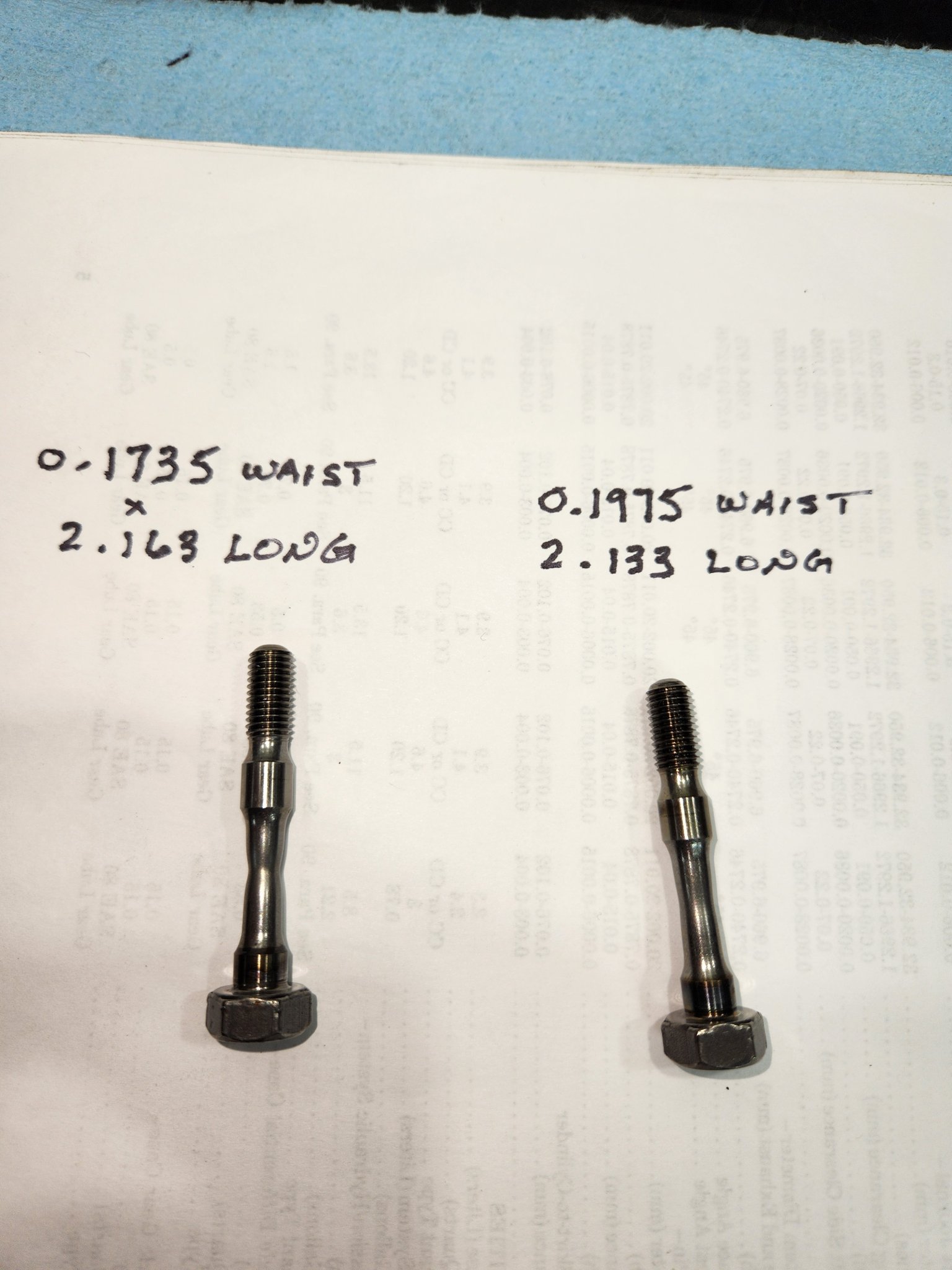

Anyway, I removed the bolts from the carrier and the bolt that won't torque is stretched, photo is attached. I'll replace all six and hope that the female threads are okay.

Those look like some sort of torque to yield bolts.
So only one of them will not tighten?

I've searched for any specs for those bolts and don't find any info. The web says that TTY bolts were first used in the mid 80's. My tractor is an 1984 so not sure. Mr. Wolf says that they are not one time use bolts which sounds right due to the tractors age.
All 6 of the bolts felt odd while torquing to specs. The pull on the wrench did not feel linear, too much rotation of the bolt with very little movement of the foot pound scale. Torqued tons of bolts in my job so I know when something doesn't feel right and it's time to stop and find out what the problem is.
Thanks, Larry.
34,257
9,466
You have the old style of bolts, and yes they are know to stretch over time.

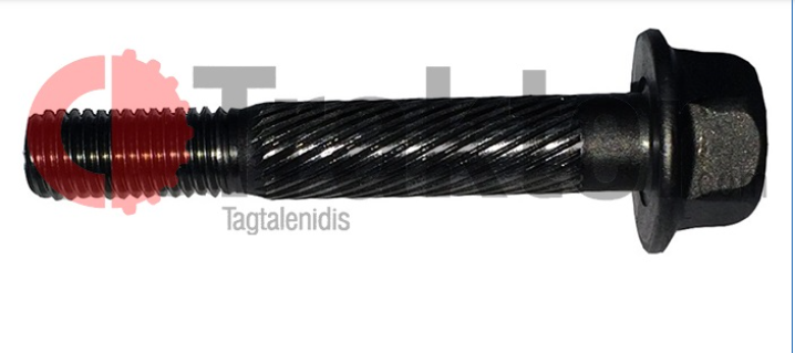

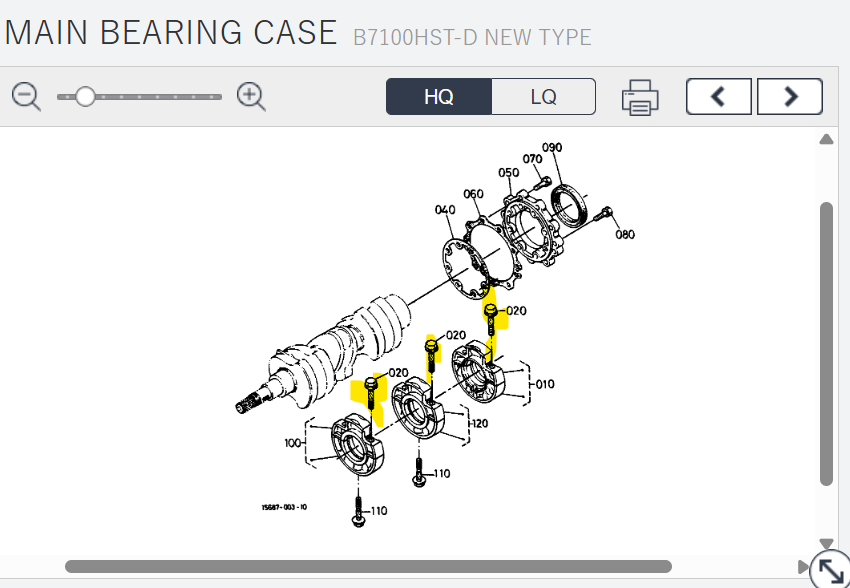

This is the newer style of bolts.
They are a replacement, and they are getting very hard to find.
