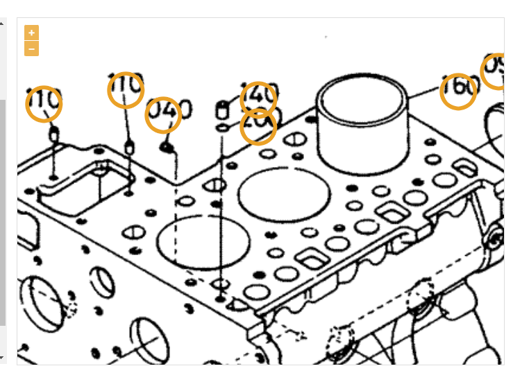

Closest thing I can see in the parts breakdown is item#200 in the parts diagram is an oring. But it looks like its under a pin/pipe. It also doesn't look that close to an exhaust valve.

Good you found the. O-ring. Goes around small stand pipe over the head gasket. Just check and monitor oil in coolant.

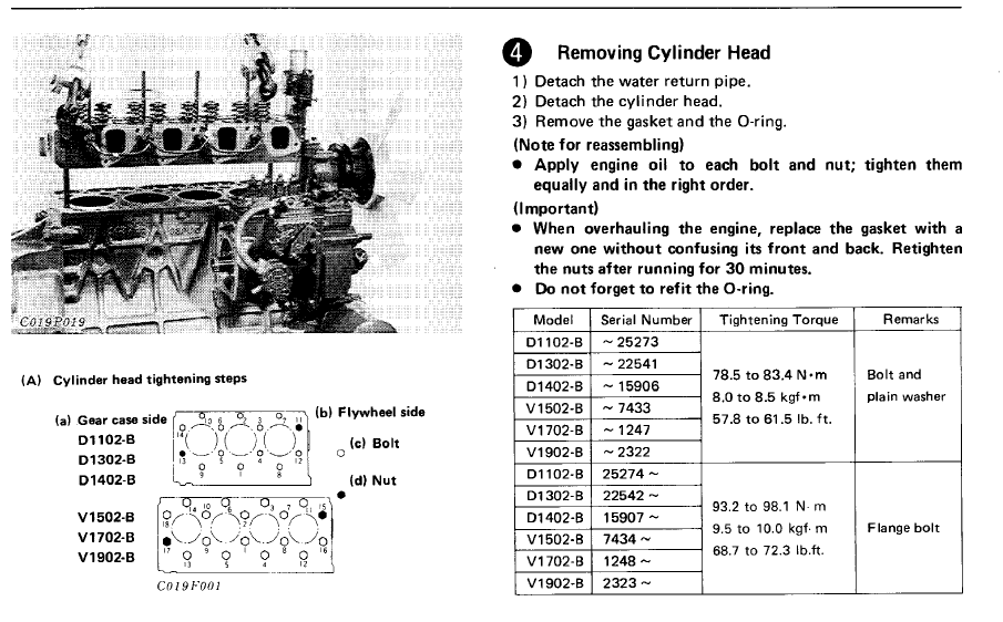

guess you're right. service manual even says right there "Do not forget to refit the o-ring"

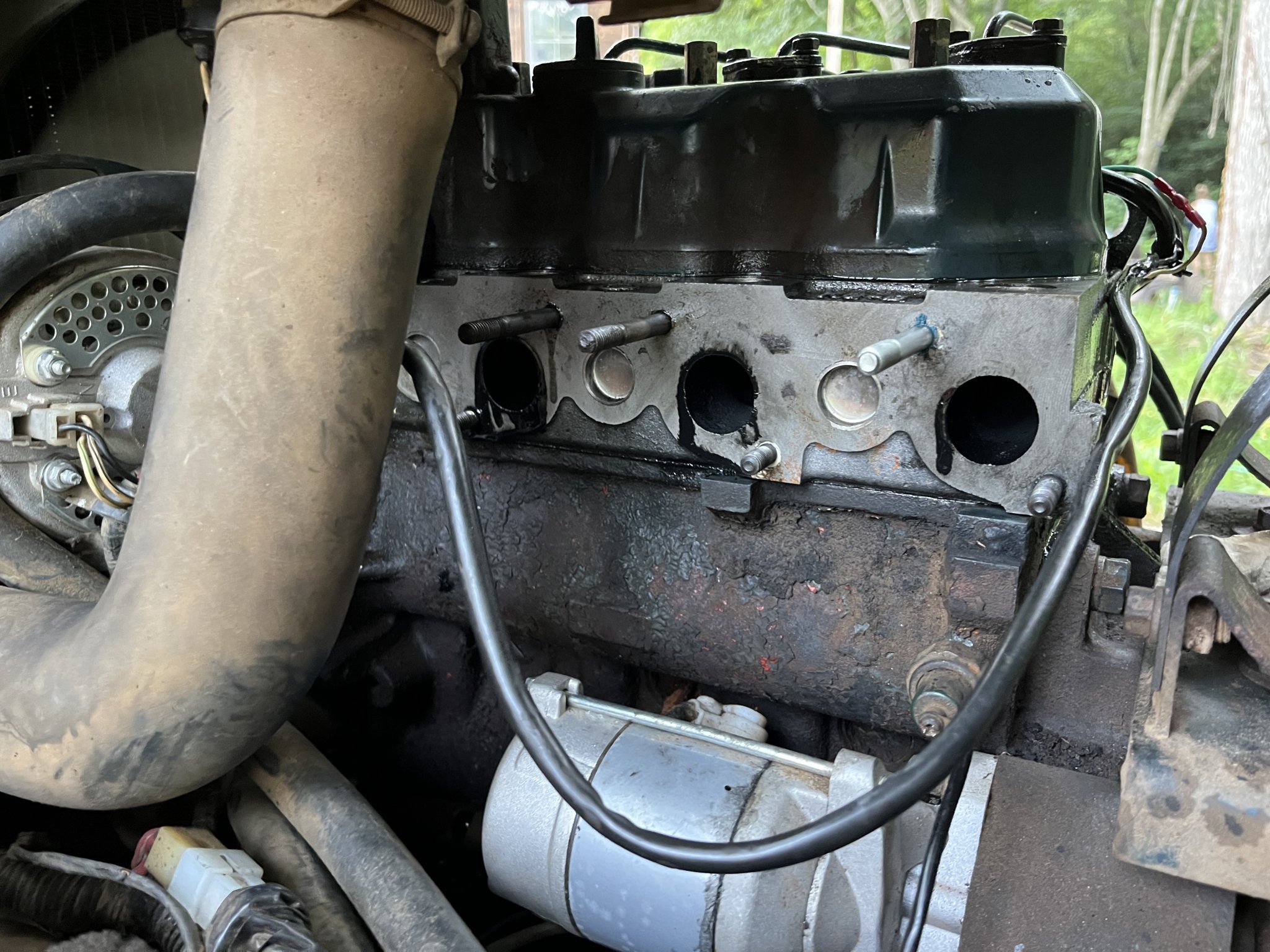

Look into the exhaust ports. Is the oil coming down from the top of the port where the valve goes through the guide? Possibly around the guide?
