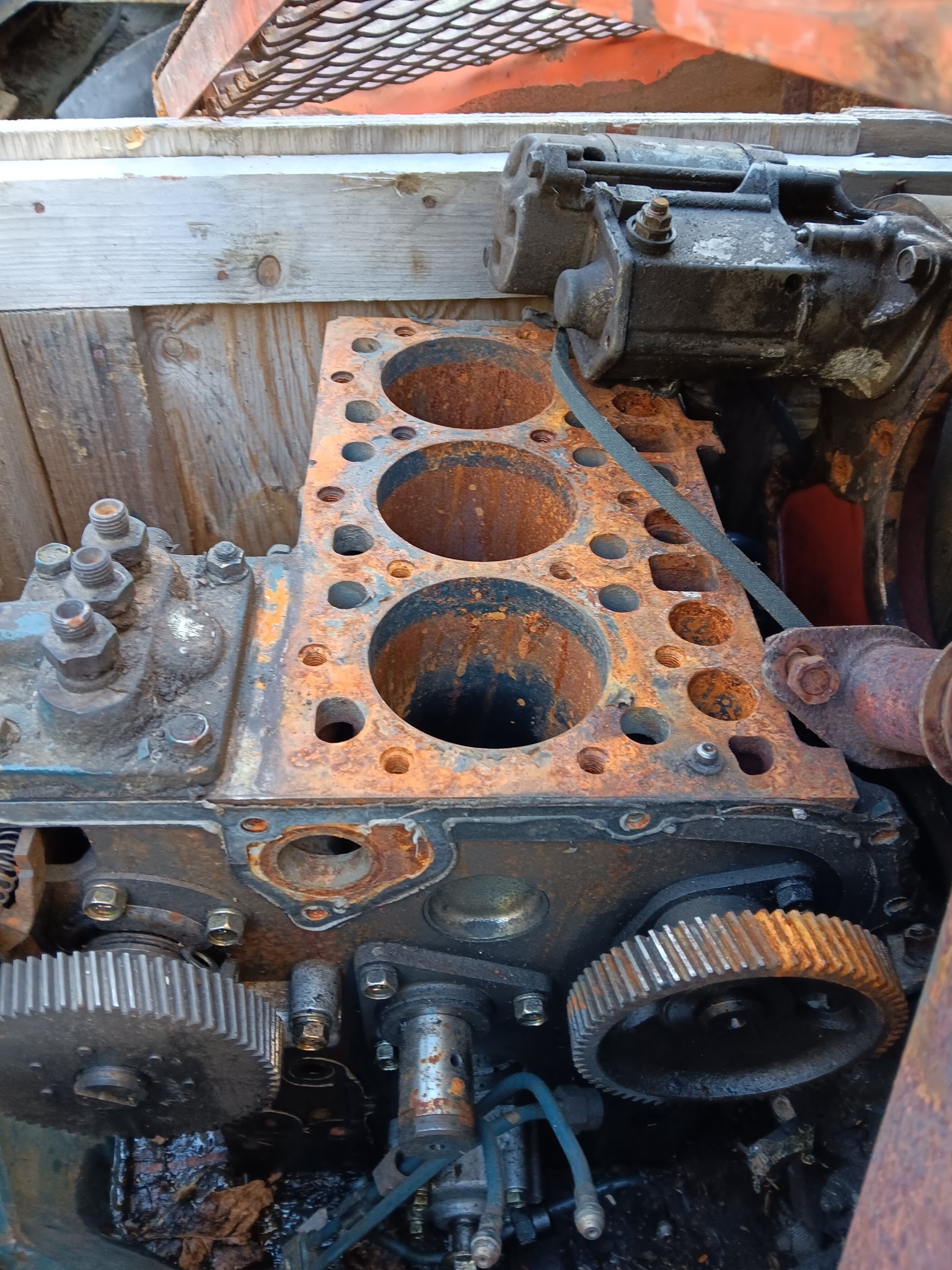

The engine is disassembled in a box. From inspection, it spun a bearing. It's also missing the cylinder head, both manifolds, injectors, etc.

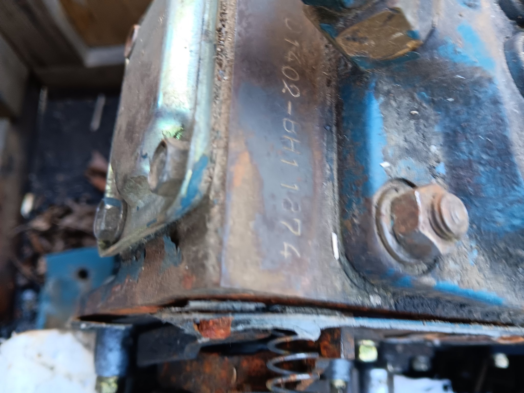

The original engine serial number is: D1402-BH1 1874
I've tried to reconcile what I have using Kubota's serial number chart without success. It'd be helpful to know the engine series, any specifics, and year if possible.

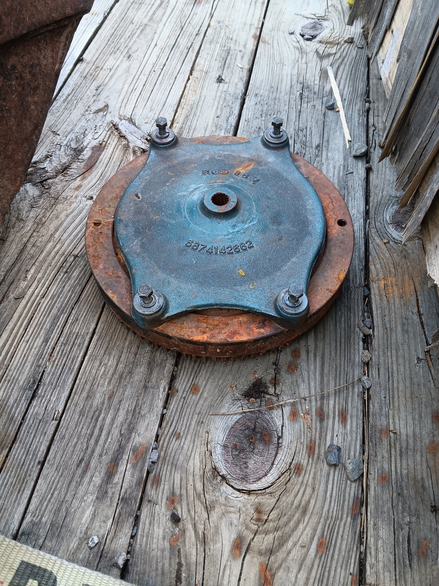

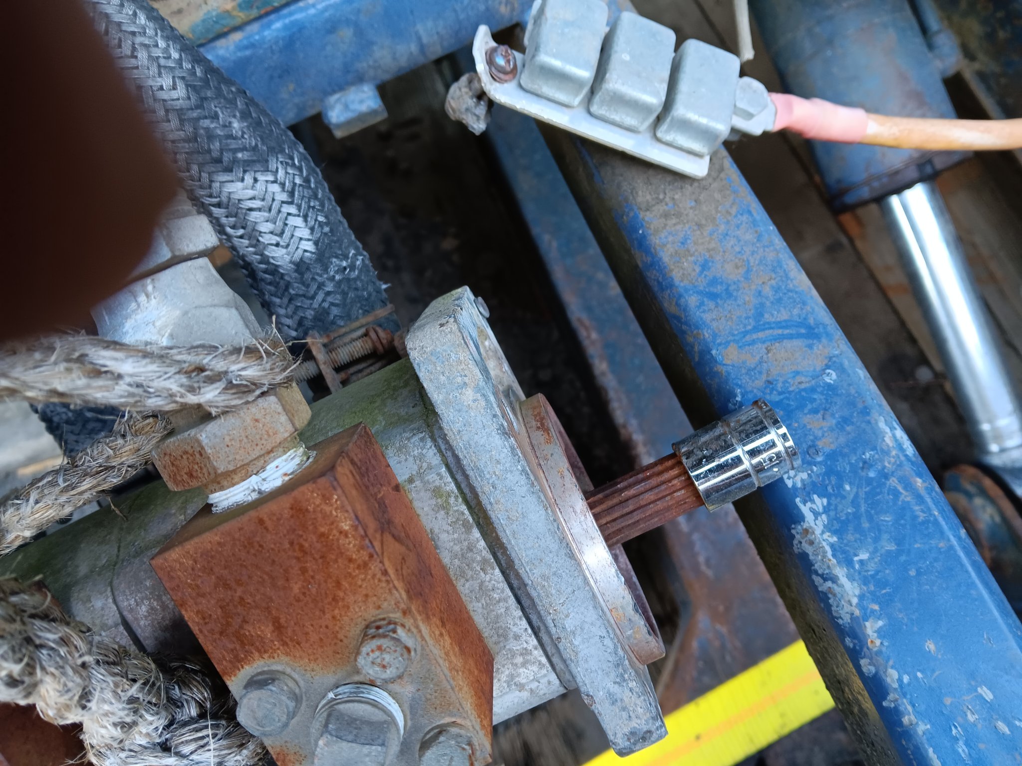

Sorry I neglected to answer your question! The main hydraulic pump attaches via its own adapter and bellhousing cover. I've attached pics.

I haven't been able to figure out what the BH1 stands for on my original engine. Would you be willing to decode it?

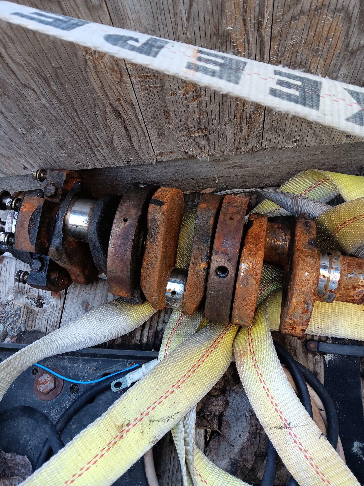

Finally, I've also attached a couple of pics of the original d1402 block and crank. Please keep in mind this is how I got it from the auction. They're actually not that bad and will clean up nicely I think. Just haven't gotten to it yet.

Yes that bellhousing will fit quite a few models. and it will fit the D1302
The letters after the numbers mean how it's equipped.
You can use a -A motor in place of a -BH1 motor, you'll just need to change the throttle plate and the hydraulic pump block off plate.
The -BH1 probably has a different fuel cam with no provision for the Hydraulic pump bolted to the side, under the injection pump, but that will not affect the functional use of it.
