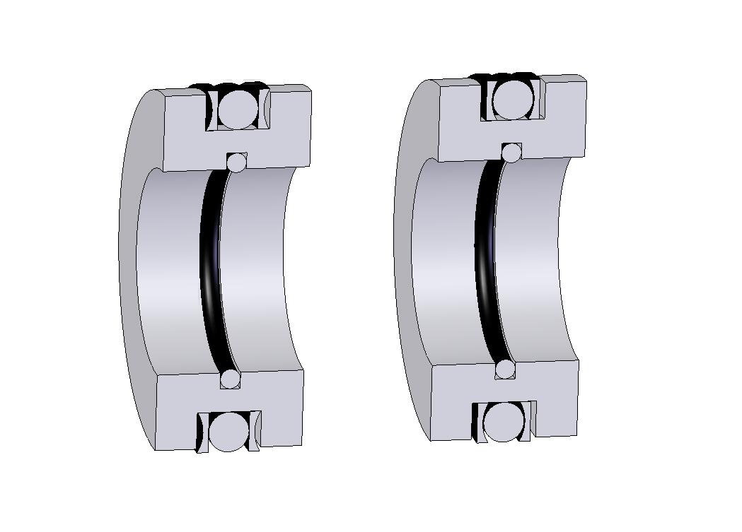

On a hunch that that Johnson built the B219 loader for Kubota, I ordered the cylinder rebuild kits for the B219 from my local Kubota dealer. Turns out the seals are exactly the same size as those on my Johnson 10tc loader.
My question: The main rod seal gets sandwiched between 2 rubber washers. These rubber washers are flat on one side and concave on the other. Does the flat part of the washer go toward or away from the o-ring?
This is my first hydraulic cylinder rebuild, and despite having rebuilt many pneumatic cylinders I have never seen these thin washers with the one side concave before. Even the washers in the cylinders I took apart to not have that concave on them.

I appreciate the effort. However that article is just a general description of a repair, that much I do know. My question regarding seal direction is extremely specific. I made a quick drawing detailing the 2 possible layouts of the seals. If anyone can shed some light on which layout will be the correct one it would be most helpful and appreciated. I'm sure in the end either would work, but I am also sure that one is better. I am not sure if the concave shape in the washer is intended to work similar to a U-cup seal, or if it is for lending a little more support to the O-ring.

Thanks for the help Vic! I think you are right, if had had to guess, I'd have done the same. I also posted this questions on tractorbynet and 2 people confidently answered me the same way.

GREG: I made a quick drawing detailing the 2 possible layouts of the seals. If anyone can shed some light on which layout will be the correct one it would be most helpful and appreciated. I'm sure in the end either would work, but I am also sure that one is better.
I'm asking the same question as Greg. I do not see the actual answer posted that he received from Vic.

Hmmm, never seen concave backup washers like that before, but rule of thumb is anything concave goes toward the pressure, so I acts as a wiper, (expands/opens up when pressure is applied), and does not just fold over and allow fluid to pass over it, so I would go with the left pic above.

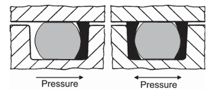

Those are backup rings and the concave surface goes against the o-ring. They are structural anti-extrusion devices not seals and they go opposite the pressure side of the o-ring. For a double acting cylinder there is one on both sides of the o-ring. Drawing below taken from the Parker O-ring Handbook. Its 292 pages of just about everything you could ever want to know on the subject.

You are welcome. Another tidbit - the theory is the curvature compresses the ring inward away from the extrusion gap. The concave style was popularized by Parker and they are commonly called Parback rings (Parker's trademark). Sort of like photocopiers are commonly called Xerox machines.
