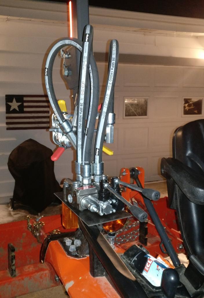

Posting the old photos of my progress on the remotes prompted me to get off my butt and get some more work done today. Here is what I have come up with to connect the valves to the outlets. I could probably do everything a little tighter and cleaner with rigid lines, but I don't know how I would bend them and I'm sure they'd be more expensive.
These flexible lines and fittings have not yet been crimped. I wanted to double check the hose lengths to make sure it was going to fit. I think this will be fine, I will just have to be careful not to catch the hoses on anything as at least one of them will stick out from the side of the ROPS a couple of inches. I could probably cable tie them to hold them in a little tighter to the ROPS.
Once these are crimped, I will need to plumb in to the PB circuit for the BH 77 and also tee into the tank return low pressure line.
Does anyone know what size hose that tank line is?

I thought about the set up with the hoses and wasn't happy. Good news is that nothing had been crimped yet. I was able to work something out and ended up with a little money back in my pocket, smaller hoses, and a bit tighter set up. Should be less in the way of my elbow and forearm when using the remotes and less likely to snag something along side of the tractor.
I ended up using 3/8" 3000 psi hose from Parker with female JIC fittings on either end, along with some adapters to get everything to connect.

Just my 2 cents, that’s a lot of hydraulic pressure right next to your head! If one of them lines were to blow it could be very bad.

I thought about that. I certainly didn't skimp on those hoses for that reason. The working pressure they're rated at is 3000 psi and the relief valve on the remotes is set at 2500. Best I can figure, burst pressure on those hoses is 12,000 psi. Does that make you any less worried?
The factory option isn't much farther back - still forward of the ROPS (pic below).
