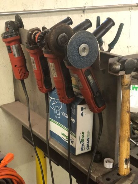

Another thing I learned was how much of a PITA it is to change from cutting blade to grinder to wire wheel.
Then the solution popped into my head.....Just buy 2 more angle grinders...simple.
So to the computer I go and 24 hours later the Stork drops one off at my door. (next month another one will appear I'm quite sure)
