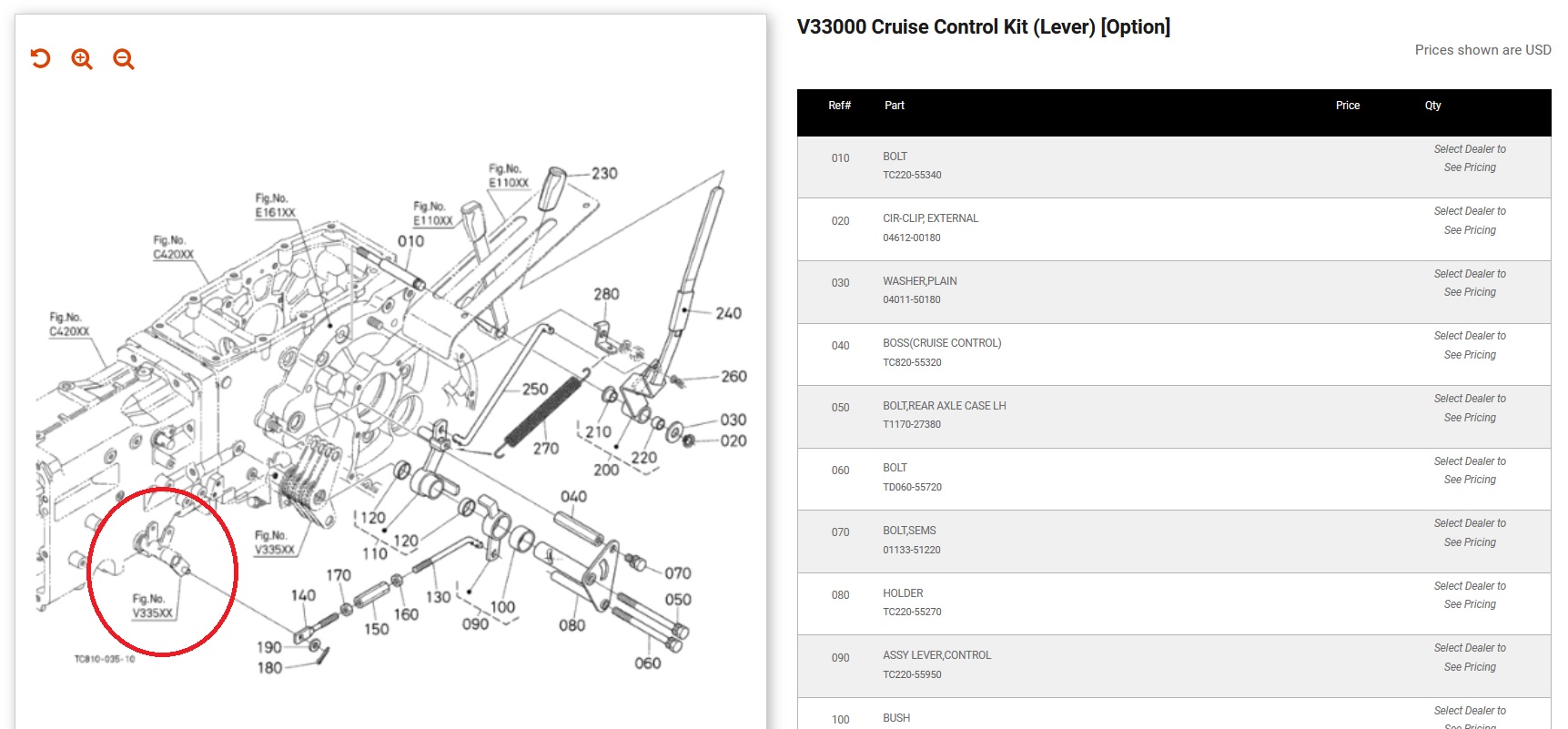

Hey guys, new to the forum but just recently acquired a 50th anniversary edition L3902 and was interested in putting in the cruise control option. It is an HST model and will be doing a lot of brush hogging with it, so will help with the long runs across the property.
I have looked through the instructions and even reviewed someone’s video that details the completed installation but the issue I’m having is that there should be a piece that connects to the treadle pedal on the left side of the tractor but I don’t see that piece to attach to.
So, is the L8455 (cruise control kit) compatible with the L3902 (or any of the Lxx02 series?) If so, what am I missing?

If you bought the correct OEM K kit for your machine it should just bolt on plug in and go.
My M59 has electronic HST control similar to the L6060 so no linkage going to the foot pedals. Do you have the right kit for your machine?
old and tired
L2800 HST; 2005; R4
Just guessing here, the treadle pedal is already hooked up to the rod that goes through the transmission (and out the other side) which is where you hook up (tie in) the cruise control to.
Cruise control is mounted to the left side... the right side to the treadle pedal is already hooked up.

L3301 owner here. HST pedal is on the right; but my cruise control lever is on the left. From what I see on internet websites, it will be the same location on the L3902. Looks like cost of the kit is almost $300. Should be L8496?

Thank you for providing the part number. Apparently I picked up the wrong part number as I have the L8455 which is for the 01 series but since I have the 02 series, looks like I will need to return this kit and get the L8496 one, which is designed for the 02 series. This would explain why nothing made sense!

So, just an update. Picked up the correct cruise control kit for the L3902 a week or two ago, but it’s been way too hot to get out there and get it installed. (Southern heat wave)
However, I was able to get out there last night and this morning to get it installed because the weather is actually bearable now.
Had a few issues getting it all put together but ultimately got it put on and working for the most part. The only part that doesn’t seem to be working is having it disengage the cruise control when the brakes are pressed. Couldn’t get that part figured out, but for now, we will just manually disengage it until I feel like spending the time trying to figure it out again.
But thanks to everyone on helping me get it all sorted out. The new kit definitely fit better than the old one. Guess it helps if you get the correct kit for the model you have! ☺
