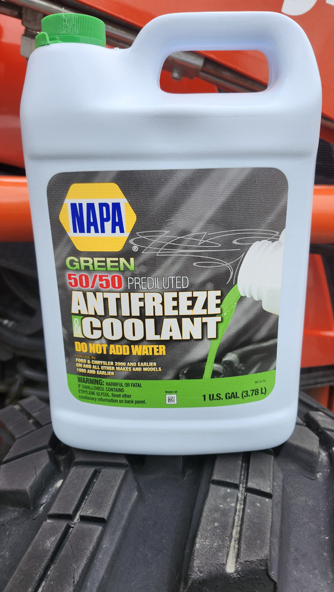

I would be surprised if the NAPA coolant is IAT. What does it say on the front label?

This is the stuff that the local Kubota dealer sells. I don't know why they don't sell Kubota branded coolant, but I remember the parts counter guy telling me that they get it through NAPA and have a MAP agreement with NAPA.

That appears to be old school IAT coolant. Its your tractor so do what you want but I would not use that in anything I own including the 1951 Ford 8N. It needs to be changed annually not every two years.

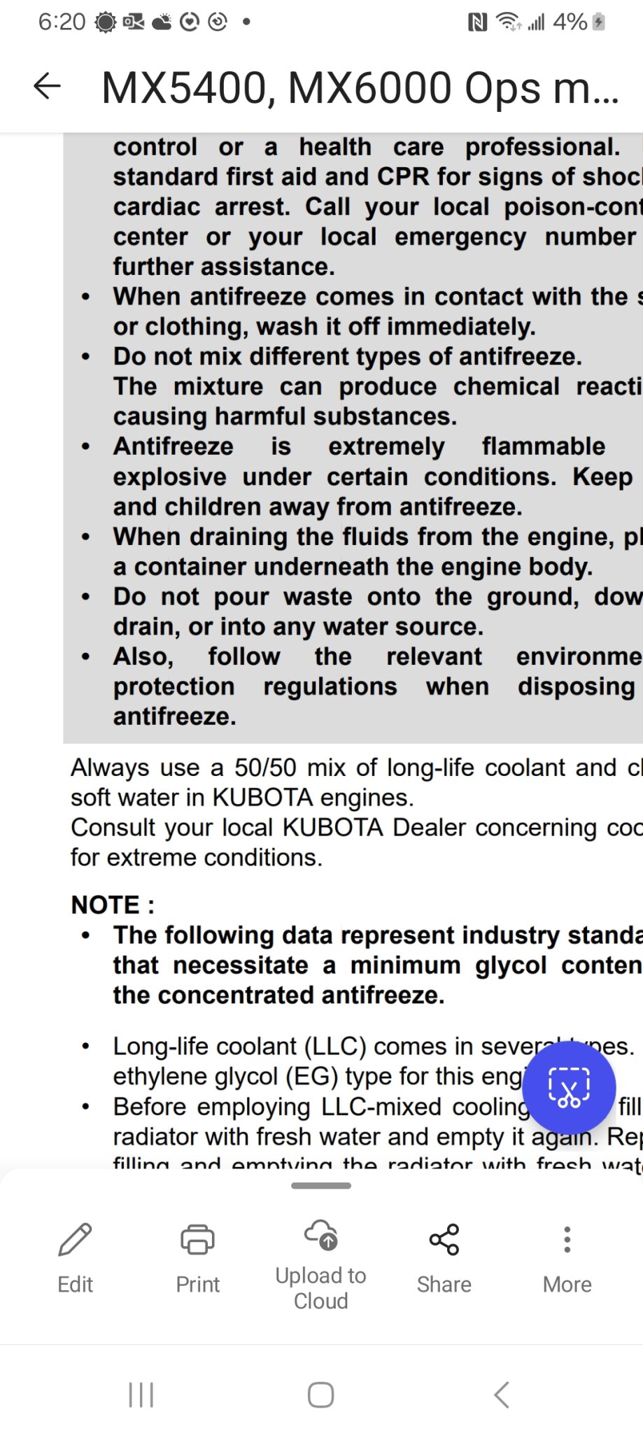

I dont know why a Kubota dealer eould use it - its not what Kubota specifies for their equipment. The operator's manual for your MX6000 is quite specific - use only long life coolant. I imagine the M6060 says the same.

All Kubota wants is a modern long life coolant. There are dozens of products on the shelf at your local NAPA, Walmart, Autozone, TSC, ....
When I look at long or extended life coolant service intervals, such as the chart in the link below, it seems to be a lot longer than two years. Kubota's recommended service interval seems to be more inline with conventional coolant. Regardless, I'll find something else and pass on the content in this thread to the local dealer in case they're not aware of the disparity between what they're selling and what Kubota recommends.
