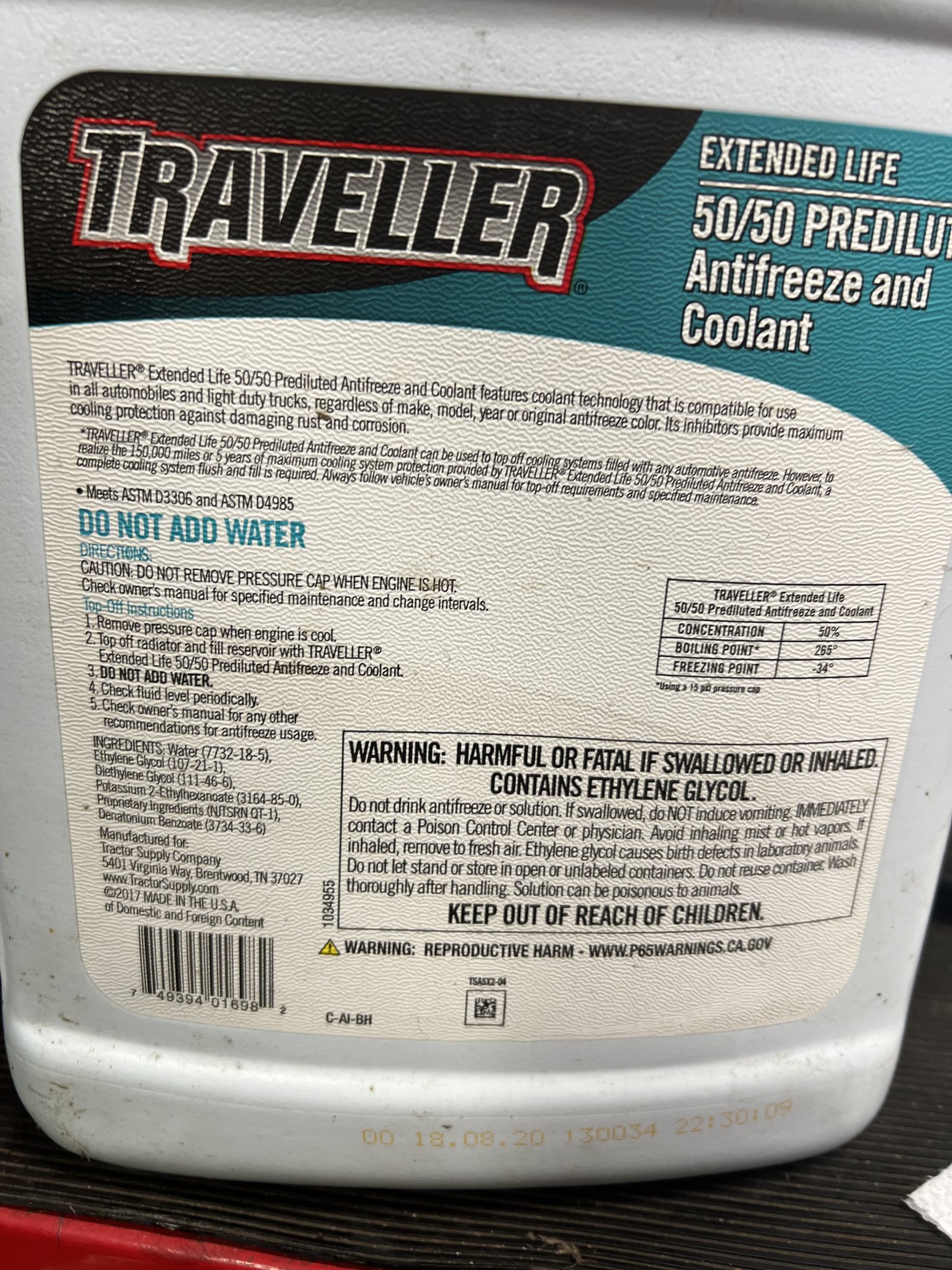

I buy coolant for the tractors from the local Kubota dealer but it's just NAPA branded 50/50 prediluted green stuff. It says on the label that it meets Ford ESE-M97B44-A, ASTM D3306 and ASTM D4985 and this is what the local Kubota service/parts department recommends. The owner's manuals simply state "fresh clean soft water with anti-freeze." Thanks Kubota! 😂
Is that Motorcraft premix stuff special in any way? I run Motorcraft gold coolant in my F250 7.3L which is a "special" coolant for diesel engines and is supposed to reduce cavitation and pitting of the cylinders. I wouldn't put that in my tractors though.

I learned something today. The Denatonium Benzoate in the NAPA coolant is added to make it taste awfully bitter to prevent ingestion, or at least to make it less enjoyable to drink. Supposedly, concentrations as low as 10ppm are unbearable for most people.

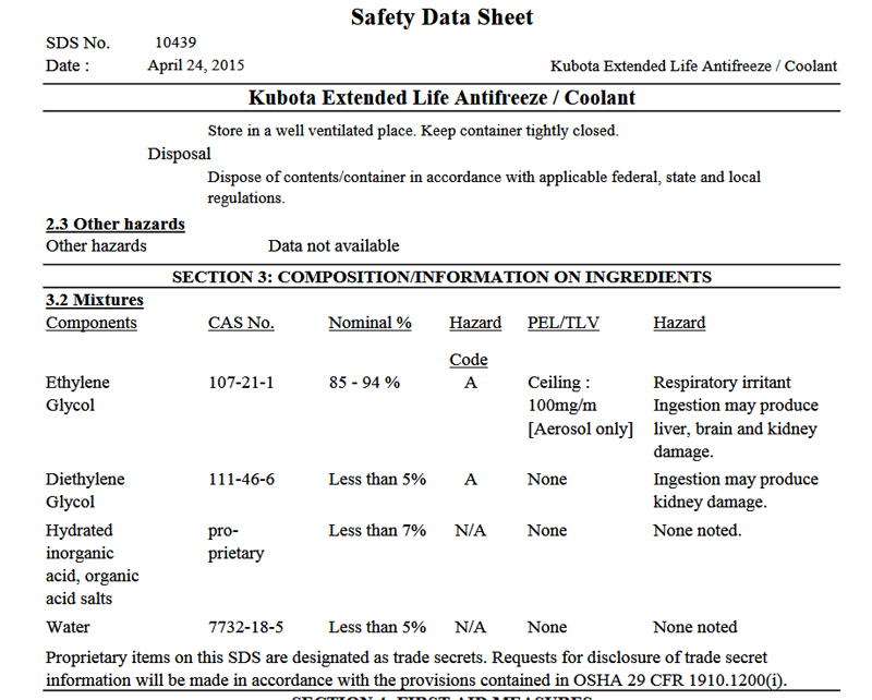

As for what's in Kubota coolant, the stuff that Messick's sells, the MSDS lists the formulation of the inorganic and organic acid salts as being proprietary. I've been under the impression for decades that some amount of silicates in coolant intended for diesel engines is a good thing. The NAPA stuff lists it as being a "low silicate" antifreeze, whatever that means.

The MSDS for the Kubota stuff mentions both organic and inorganic acids being present.
The MSDS lists hydrated inorganic acids and organic acids in some unspecified quantites. The specific chemistry is "proprietary".
