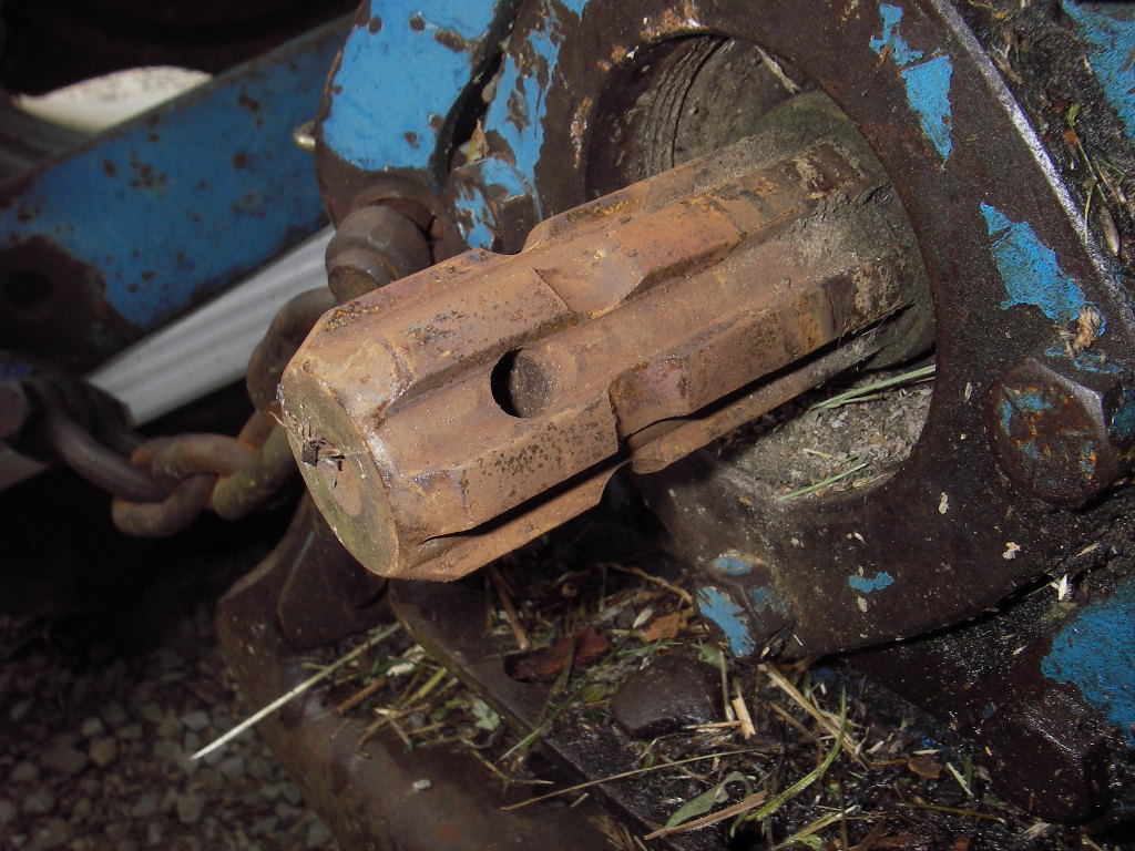

It's true I'm guilty of building unnecessary parts just for the fun of it but consider the following:
If you don't grease your PTO output splines they will look like this after 45 years.
Not a huge problem but it does make attaching the PTO drive more of an argument than a nice sliding snick home.
If you do grease the splines, you need to keep dirt and sand away from the grease or it will turn into grinding compound which brings its own problems.
