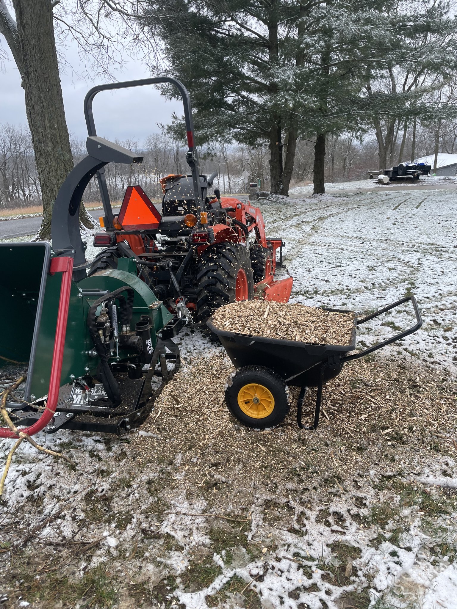

I did get the WC68 and am happy with it. I am able to carry it with my quick hitch, although it is heavy and I wouldn't want to be going over too much uneven ground with it. Because of my relatively low horse power, I can only chip up things that are at most 3 - 4 inches in diameter depending on the state of decay. But it has been chipping like a champion for a few years now.

Rob:
I don’t have any experience with the woodmax. I just know that I was a bit surprised at how heavy the WC 68 “felt”. But if you have your wood chipper attached you aren’t looking to go anywhere fast. According to specs, it seems like weight is not an issue.
According to tractordata.com the rear hitch data for lx2610 is:
rear lift at ends: 2139 lbs
rear lift at 24”: 1676 lbs
I have mine attached via a quick hitch which will have some effect on things. But the wc68 is only 710 lbs, so according to the specs it should be well within the tractors ability to lift. I have not had a problem moving around just taking things slow and keeping the hitch low without hitting the ground. I just would be reluctant to do any wild maneuvers with it attached but that’s common sense.
