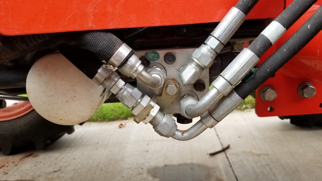

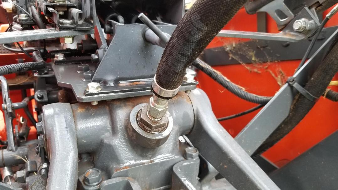

I'm in the process of swapping out L3800's as I got a newer (lower hours) one on Craigslist a few weeks ago. My old tractor had filled ag tires which I prefer so I swapped them over to the newer tractor which came with R4's. My old tractor also was set up for my BH77 backhoe so I need to get subframe and such moved over to the newer tractor. The new tractor has a rear remote which is kind of a cool plus. However, I'm not sure how to connect in the backhoe along with the remotes.
Therein lies my question. Where do I tie in for the backhoe?
Beginning of swap:
Front view of remote. You can only kind of see the lever as it's in the foreground and blurred. I have no idea why it's such an enormous plate.
Power beyond/hyd block setup
Remote connects
Dump back to tank?

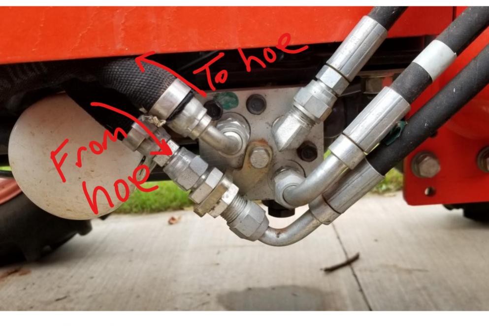

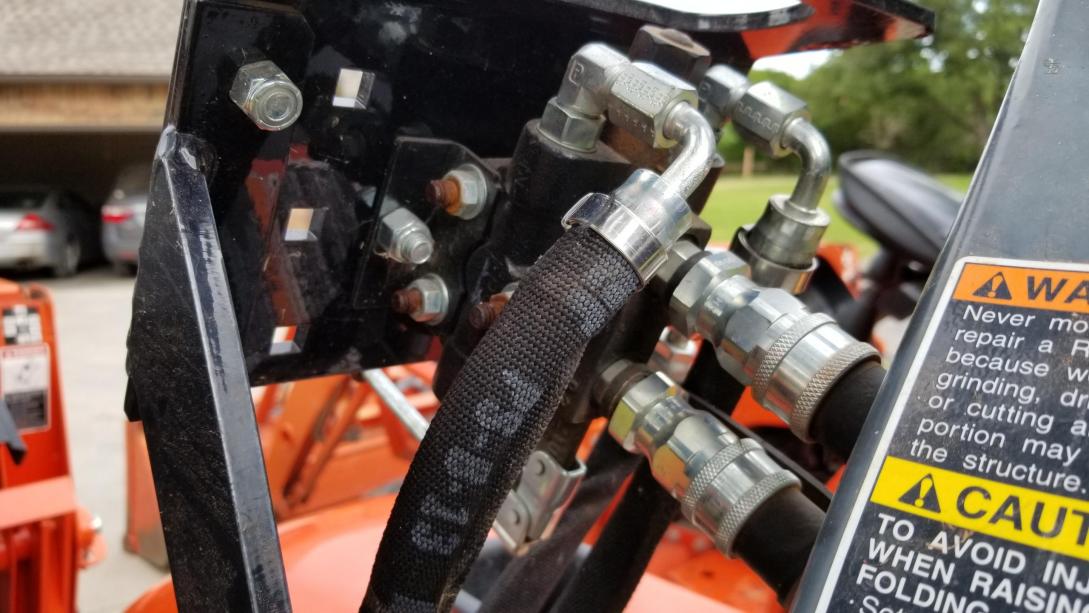

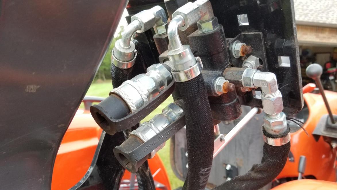

I don't have the hydraulic circuit of an L3800, nor it's backhoe.
Where is your current backhoe plumbed, does it have a selector valve for 3pt or hoe?
Looking at photo 2 of the hydraulic block I assume the following.
Top right - Pressure to FEL valve
Bottom right - Tank return from FEL
Top Left - Power beyond from remotes to 3pt
Bottom hose - Power beyond from FEL, going to Pressure for remotes.
Pic 3 - Tank return from remotes.
How many hoses from your existing hoe to the tractor, and do they all go back to the block?
Backhoe would most likely break in between the remote PB hose and the block (unless there is a selector valve) as you would then still have the relief in circuit. Return to tank teed into lower return with FEL or with remote return
100 td
B21TLB (B21, TL421 & BT751) Toyota SDK4 T116 Bobcat
Aug 29, 2015
1,776
9
38
ɹǝpunuʍop
As the hydraulic block has a built in relief valve (separate to the 3pt relief), I expect you could break the FEL to remote hose to feed the hoe, this would remove a slight restriction of the hoses up to and through the remotes. It would of course add the same to the remotes by virtue of the backhoe hoses and valve block. It depends where you want your priority to be. All said and done it may only be a very small pressure drop, to either. You could also shorten a hose and send your PB from the hoe directly to the remotes. So FEL PB hose to Backhoe P hose, shortened Backhoe PB hose directly to Remotes P, existing PB from remote to block. YMMV

Thank you so much for your feedback. I'm anxious to sell off the old L3800 but can't do so until I get the backhoe moved over to my new-to-me L3800.
I'm not sure what all the hoses do but here's what I found out when I look at it after reading your response.
