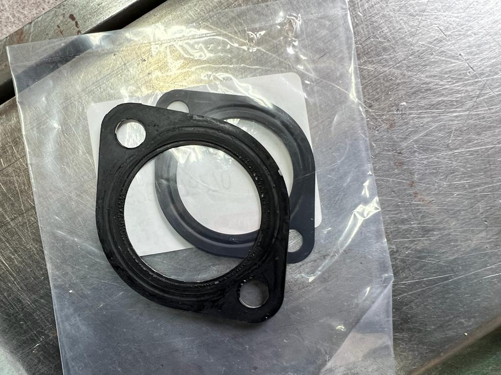

Actually have him order BOTH, $5 gaskets,be nice to SEE what the difference is but...
I'd go with what the dealer says and if it's wrong,he can reorder the correct part.

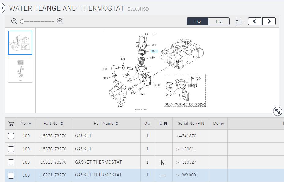

This is an interesting one.
I know there was a lot of changes going on when they built the B2100, and that model has many possible parts, in all different aspects.
The serial numbers are another oddity, as 99% of the tractors around this time frame only had 5 digits in there serial numbers, but by this parts list they are saying that there are not only 5 there are 6 digit and Letters used.
But in all of the searches for serial numbers they say a serial number or PIN number has to be 5 Digit or 17 Digit, super contradictory.
So it's making me think they might be using the engine serial numbers for these parts instead of the traditional tractor serial numbers.
Here is the full parts look up:

@North Idaho Wolfman: That software looks very nice. What is it?
The IC column shows NL, would that mean Netherlands? I am still puzzeled by which serial number now to use.
The image shows numbers with 6 digits, 5 digits, and one starting with 2 letters and then 4 digits.
So what to compare with? My engine serial number, complete XJ3489, or just the numbers 3489, or the numbers on the VIN 80829. I still would not know how to match it.

HAHAHA NI not Not NL, NI=Not Interchangeable
That screenshot is from the Kubota Parts website.
I would give you the exact answer if I could, but none of this makes any sense to me.
Neither your serial number on the tractor or the serial number on the engine exactly match what they are saying would be the right numbers.
Your tractor serial number ( 80829 ) is greater than 10001
But also your engine Number ( XJ3489 ) is greater than WY0001
So to add further confusion, the top two numbers have been replaced by:
16851-73270
Either of the bottom numbers are point to:
16221-73270
So in semi conclusion:
16851-73270 matches your tractor serial number
16221-73270 matches your engine serial number
If I was to guess I would say it's more likely to be the 16221-73270 gasket
Do you have the old gasket?
Or you might be able to tell by looking at the outlet housing.
If you look at the sealing ridge between the two different gaskets you will notice that one is round and the other has indents where the bolt holes are.

So it looks like they are using the engine numbers.
Interesting.
So you need:
T-stat 15321-73014
Gasket 16221-73270
