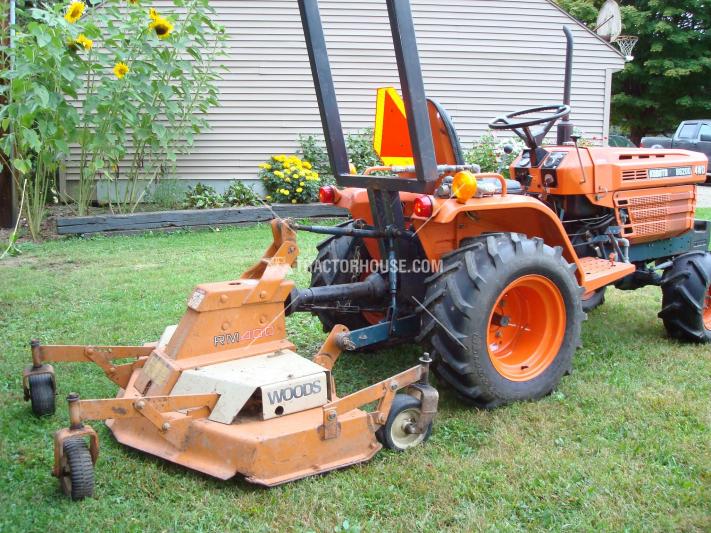

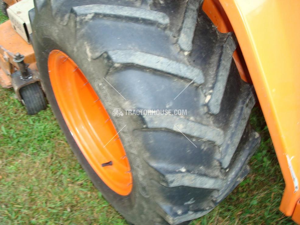

I have enclosed several pics of my tractor with R1s. It originally came with turfs and the prior owner replaced them about 2 years ago with the turf size in R1 tread. I have used it all summer and it is a little bear. I have recently purchased a set of chains to cut down and front PTO gear box so I can take the rear blower and put it on the front.
