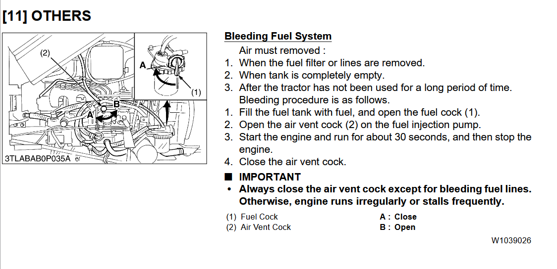

have you opened the air vent cock

The compression release on rigs that have one is really handy when bleeding. But I don't understand all the difficulty. Your enemy to defeat is ANY air in the fuel lines, the filter housing, the filter, the line to the low pressure pump and lastly the injection pump itself. Any air is going to cause you to start all over again.
The diagram in #2 doesn't mention the air bleed cap screws on the filter housing, if equipped?My old machine's filter housing has one to bleed the incoming line and another to bleed the outdoing line to the pump.

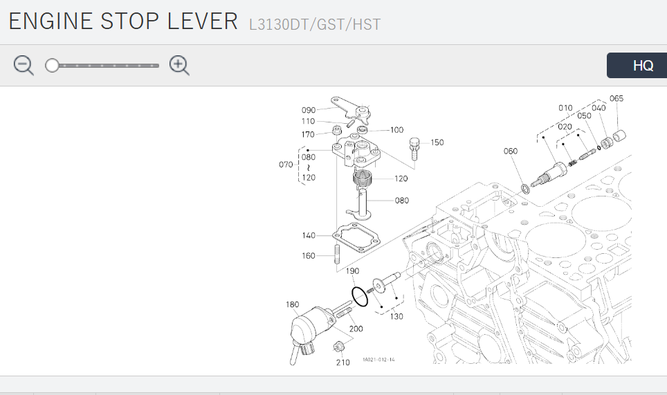

If you are getting fuel into the pump, then it's probably the Electrical stop solenoid or manual stop rod that is fouling you up.
Check for fuel to the injection pump and the stop rod and the fuses.

Not sure what the stop rod or stop solenoid are. First time I've heard them mentioned. Doni check thr injector pump same as above? Just by cracking thr lines loose?

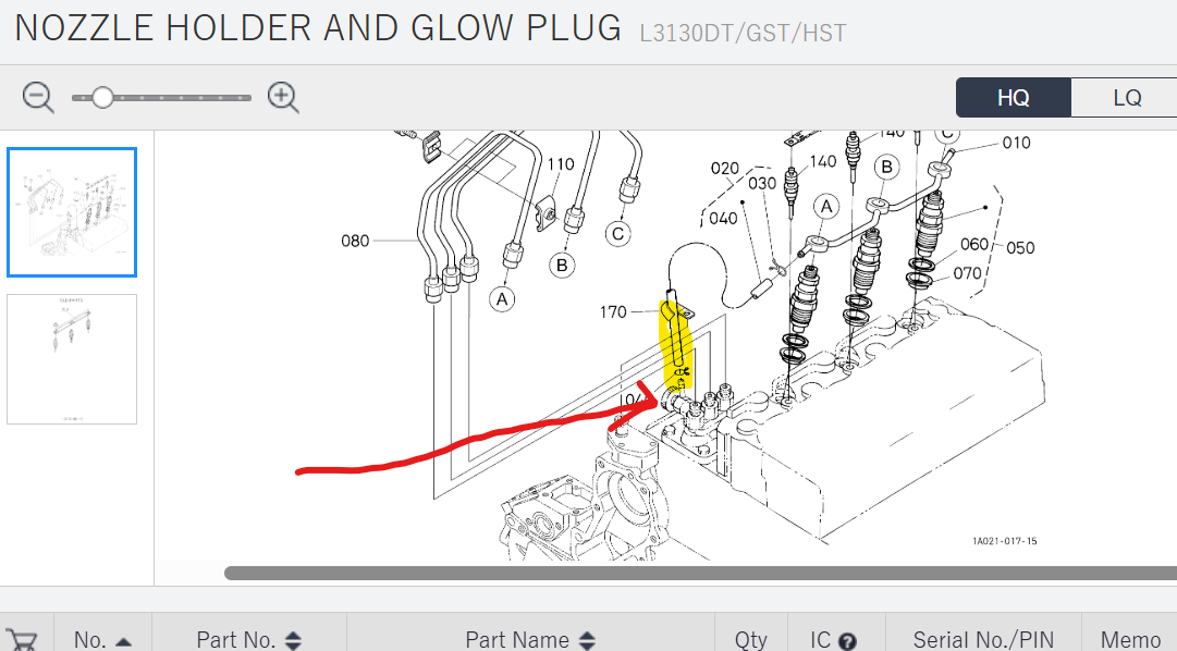

Simply remove the small vent line (YELLOW) off of the jet start valve (RED) on the side of the injection pump and crank if fuel comes out then the injection pump has fuel to it.
