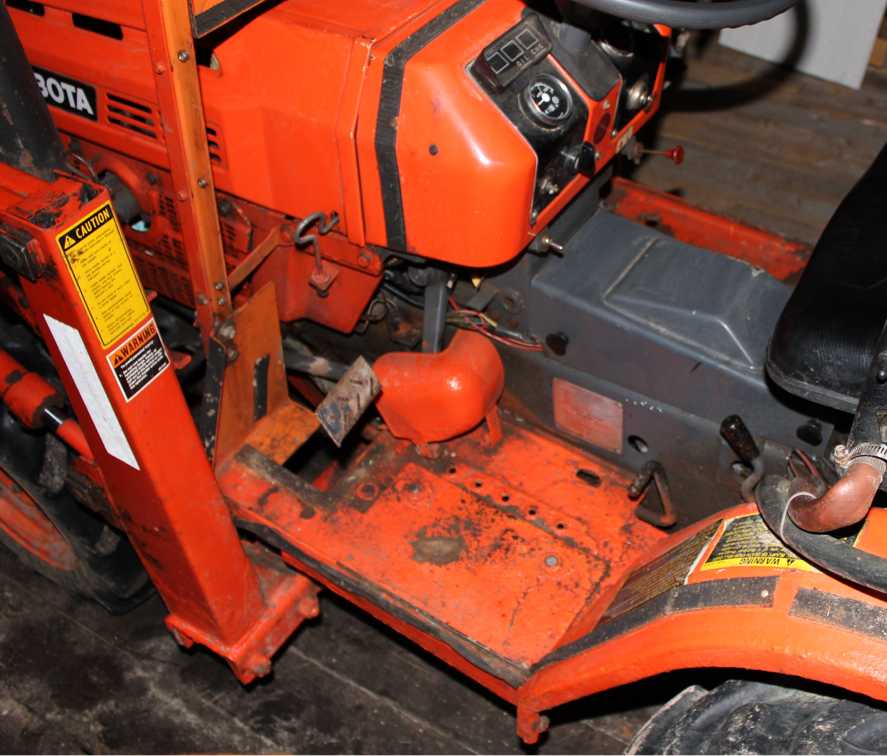

In OTT's article "Getting to Know Your Kubota's Clutch," the author says that
"Kubota recommends that when storing your equipment, have the clutch disc pressure relieved by way of placing a block under the foot board after the clutch pedal has been depressed. This relieves the pressure on the clutch and prevents it from rusting to the flywheel." Questions:
1. How many of you do this?
2. Does anyone have a photo they can post showing how a block is placed under the foot board in such a way as to keep the pedal depressed? I can think of other ways of keeping it depressed, but not this method; can't visualize it (must be stunned). Peter

I do it but not with a block. My L3400 has a pin to push in after pressing the clutch pedel down. I do it even if it's going to be sitting a couple of weeks. I think it's a good habit to get into.

i remember getting a wooden block in the supplied toolkit once specifically for this purpose but any bit of wood / material will do
you depress the clutch, and place the block between the clutch pedal bar and the underside of the floor so it keeps the clutch pedal in the depressed position
