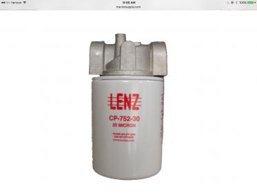

You will have find the main supply hose and reroute it to a location that a filter will ft.
You Will need metric hoses made up and a filter setuplike pictured with matching metric threads.
