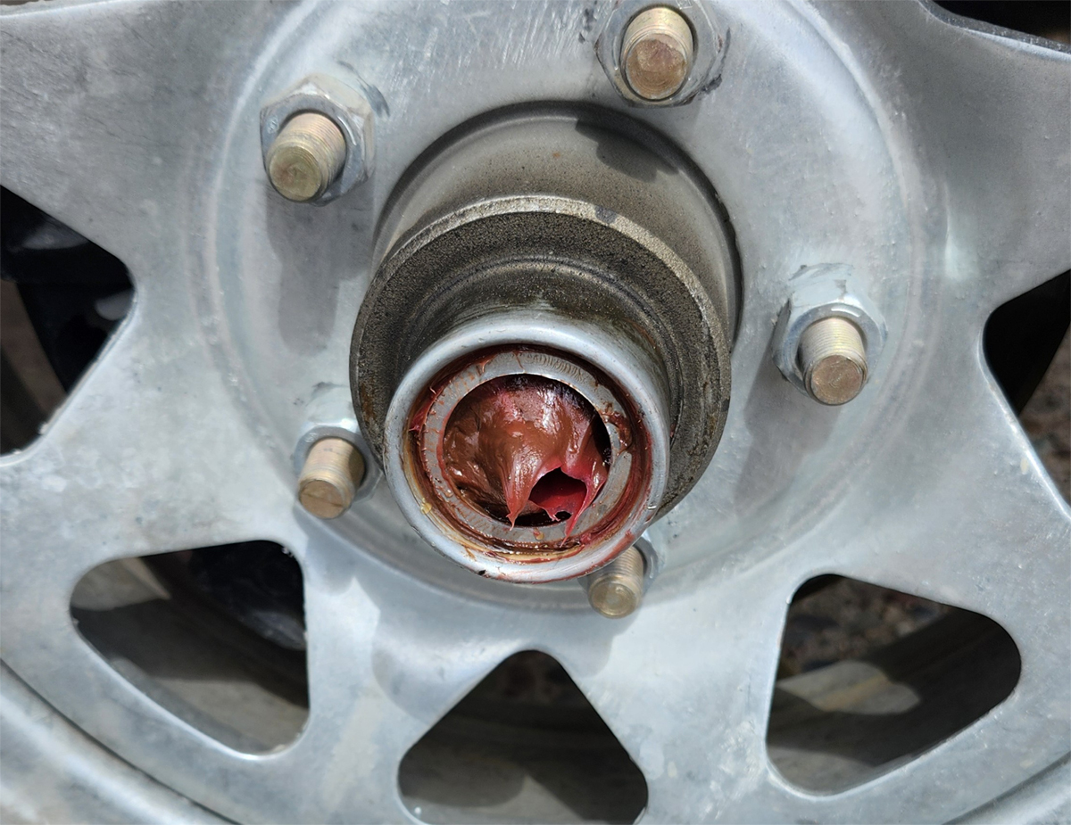

I started with the front right for no good reason and it had chocolate grease in it. I should have taken a photo but figured that they'd all be like that. I got the impression that none of them had been greased since leaving the factory in 2017, but only the front right had taken on water. At first I thought that it was perhaps a brown wheel bearing grease, but I soon realized that it was due to the water.
Here's the front right bearing after I had pumped out the worst of the chocolate grease. I'm going to revisit this bearing in a few weeks and pump more grease into it to clean out any water contaminated grease.

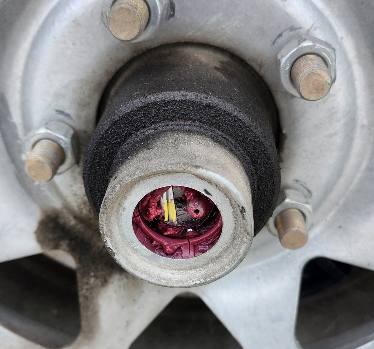

And this is how the other three bearings looked prior to my pumping fresh grease into them.

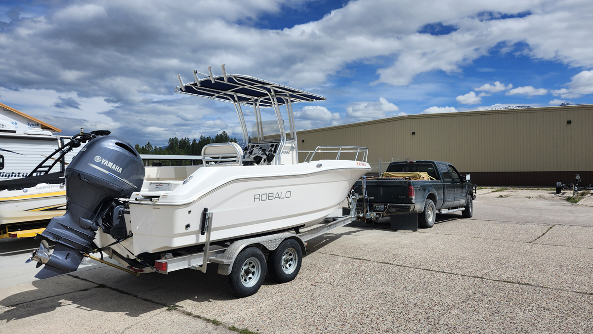

Ready to head home with greased wheel bearings.
