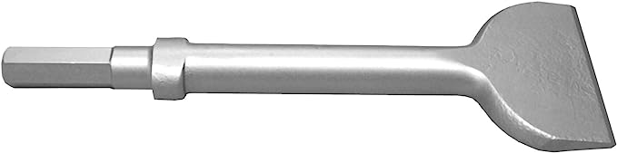

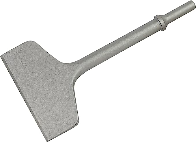

I pulled the deck off my BX this afternoon for some cleaning and grease.. I cleaned it with some simple green and rinsed it ,drying it off with a towel. The underside I scraped and sharpened the blades by hand with a sharping tool and file.
Question= Is there any method you guys use to clean the underside of the mower deck ? Do you power wash the crud off or scrape it off by hand? Is there a particular cleaner you like for getting the caked on grass off ?
Maybe there is a easier way than scraping that junk off the bottom of the deck?
One of these in an air hammer does the trick for me. Water just makes an ugly mess and is hard on bearings.
