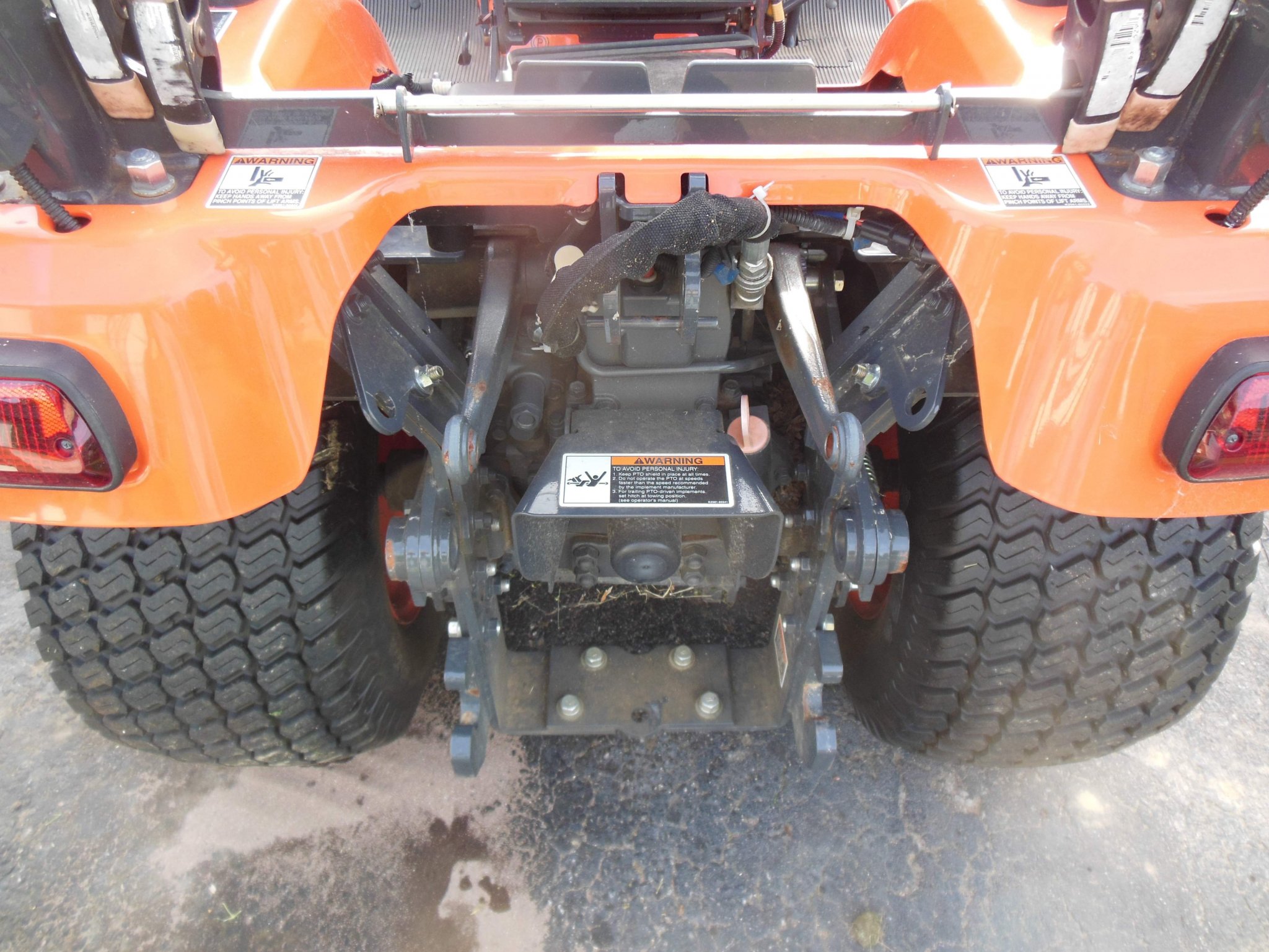

Did you find the dipstick or is it a sight glass?

Hey all, Blew a hydraulic line on my 2004 BX23 the other day. ( just bought this tractor) It only lost a quart or so. But I didn't see a dip stick in the filler for the fluid. How do to tell how much is in there? Will it damage anything if I guess and over fill a little? Thanks in advance. Russell
Your dipstick is located to the left of the 3 point cover, right by the backhoe supply hose. See picture below.
